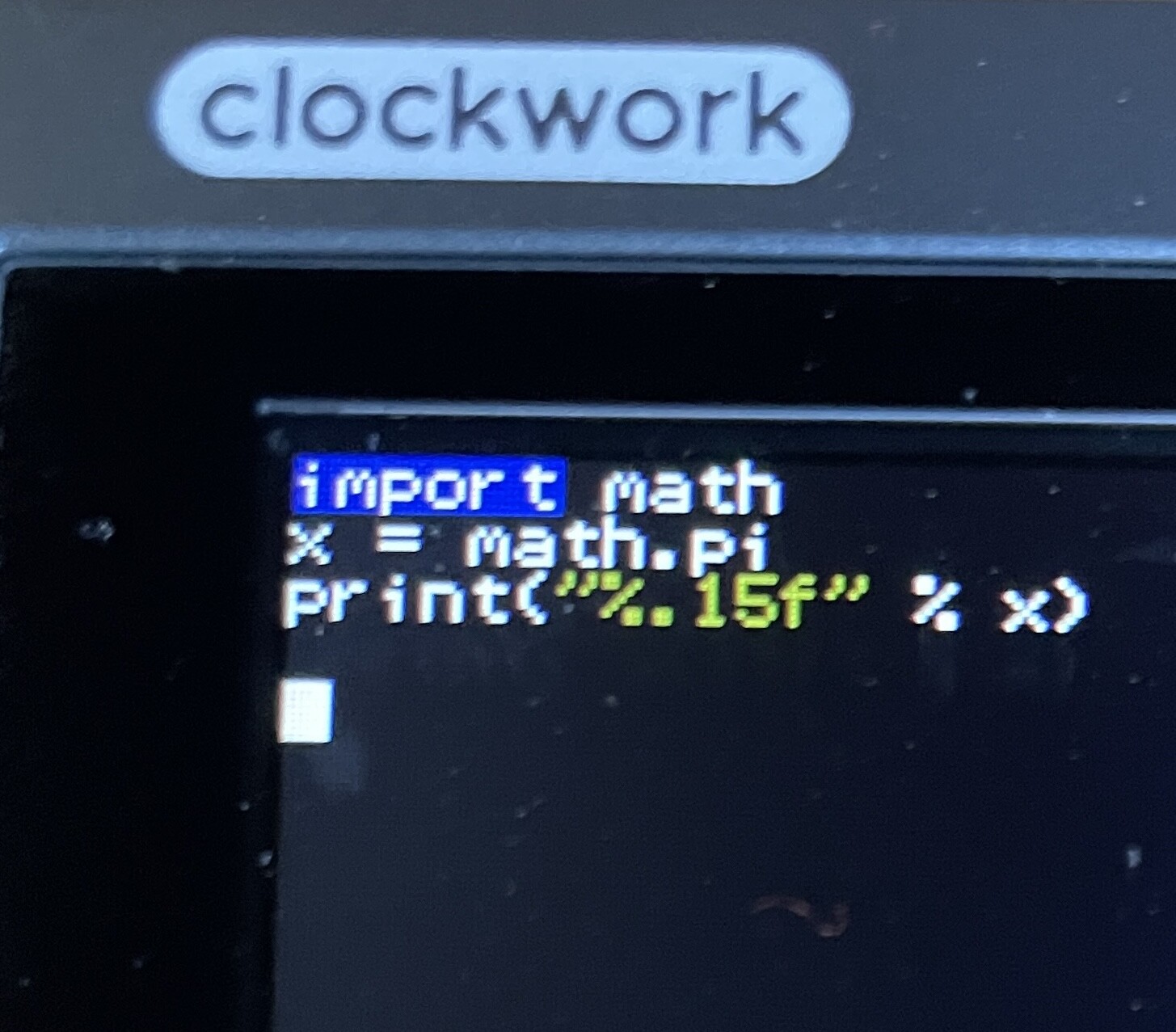

Are you running MicroPython with double precision floating point? MMBasic uses double precision thoughout.
Hi, thanks for your question. You can check out my setup and specifications in the video I made about it. That might answer your question.
YouTube: PicoCalc Performance Test
The MicroPython build uses evidently single precision floating point (about 7 decimal digits of accuracy).
3.141593 with that code:
