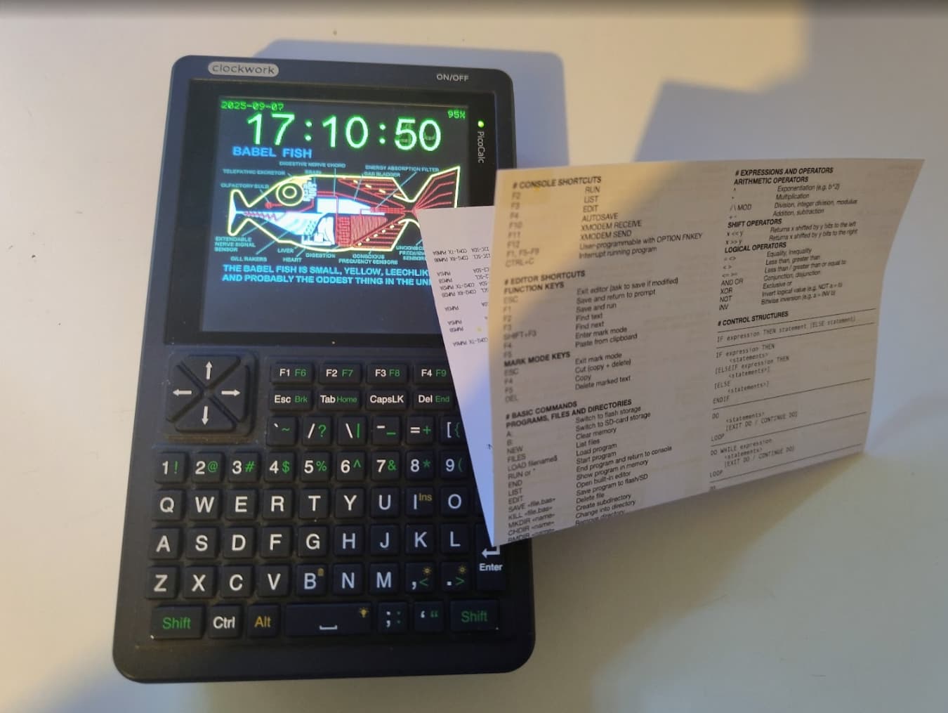

@tim9009, I hope you don’t mind, but I converted v2 PDF in to a double sided and slightly bigger print (13 x 18 cm, that folded once will still be smaller then the PicoCalc).
However, I don’t see how I can share the new pdf in this forum :frowning:
That’s awesome! Feel free to add it to a pull request to the GitHub repository :slight_smile: Alternatively you can dm me the file on Discord (You can search my name in the Clockwork discord server), and I’ll add it and credit your contribution.
I just added it to a pull request.
Enjoy!

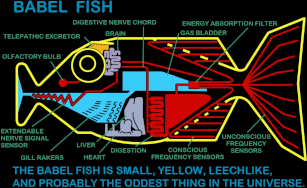

I want your H2G2 inspired theme :star_struck:
can you share the source ?
oh nice, i linked it from my Github where I’m trying to tackle the whole User Guide
Sure, it’s a very simple little hack.
CLS
LOAD JPG "BabelFish.jpg",6,66
DO WHILE INKEY$ <> CHR$(27)
  TEXT 0,0,RIGHT$(DATE$,4)+MID$(DATE$,3,4)+LEFT$(DATE$,2),"L",1
  TEXT 320,0," "+STR$(MM.INFO(battery))+"%","R",1
  TEXT 160,14,TIME$,"C",6
LOOP
PRINT @(0,256);
