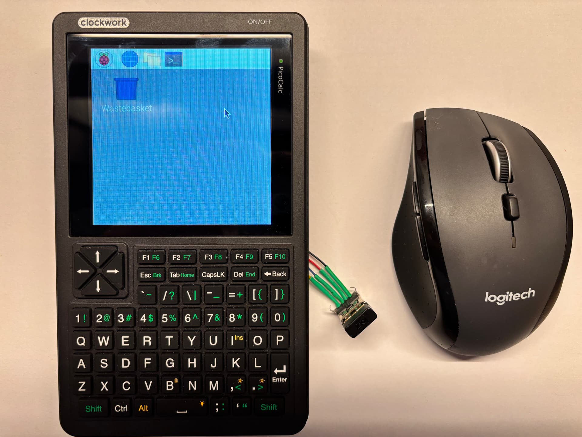

For mouse emulation,I refer to this:
“Luckfox Lyra on PicoCalc” Luckfox Lyra on PicoCalc - #210 by hisptoot
Right shift key is mouse mode toggle key in new kbd driver.
Arrow keys control mouse move and square bracket keys control mouse button.
Mouse mode should be useful in pico8 editor.
I installed hisptoot linux (buildroot)_20250419 version and confirmed it.
At that time, I was trying various things, so I don’t know exactly what process enabled mouse emulation.
If this is related to the keyboard firmware,
Keyboard_firmware in hisptoot’s Google Drive described in
may be what will do it.
Or it could be the official latest keyboard firmware
PicoCalc_BIOS_v1.2.bin (Keyboard firmware)
Can someone try this?

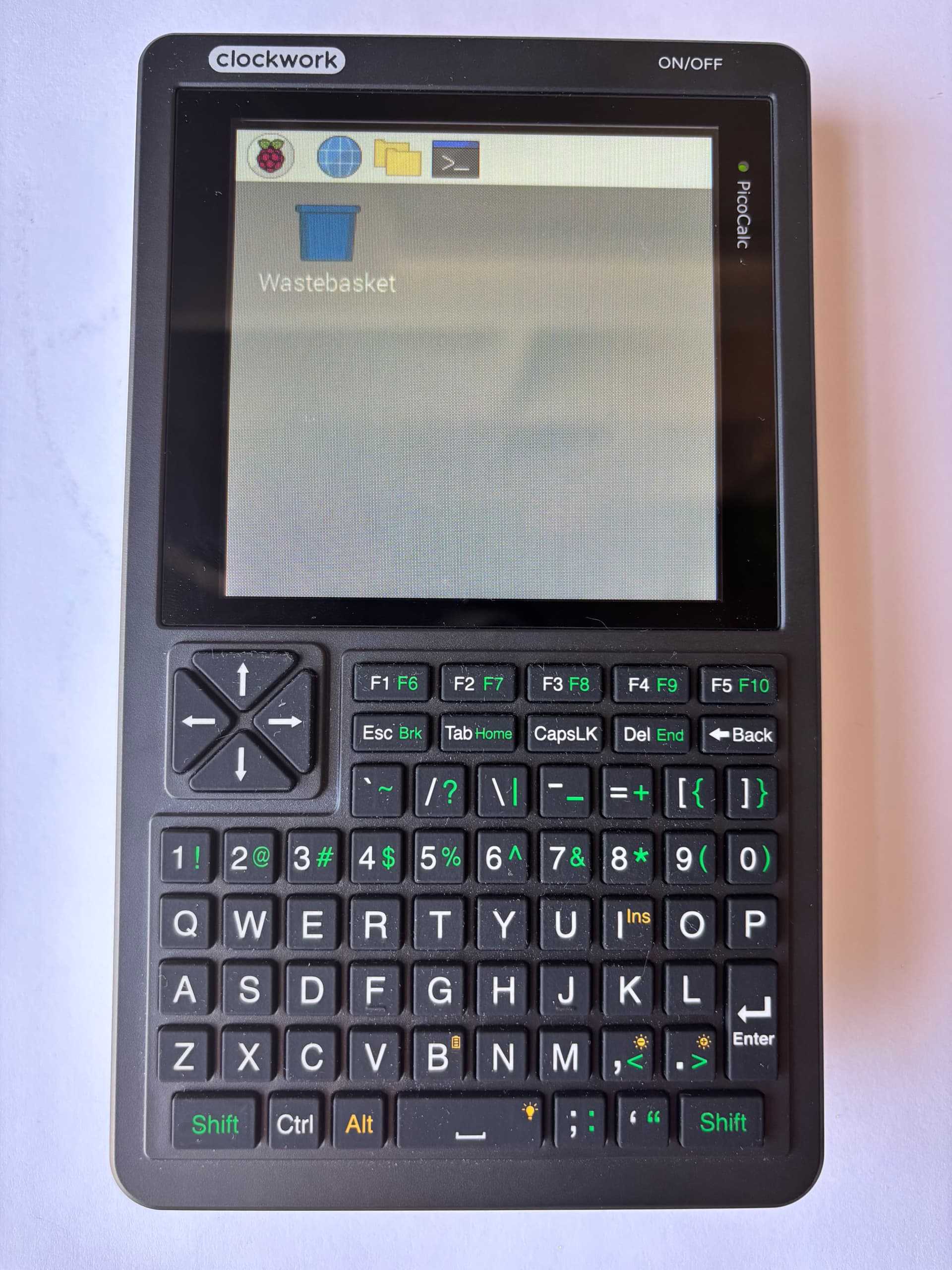

For “PicoCalc and RasPiZERO2W”, I prototyped a PiZero cover for the back panel of the modified PicoCalc and uploaded it to Thingiverse.
I also described how to make a simple relay board.
It looks like this.
Yes! Mouse is working great on v1.2

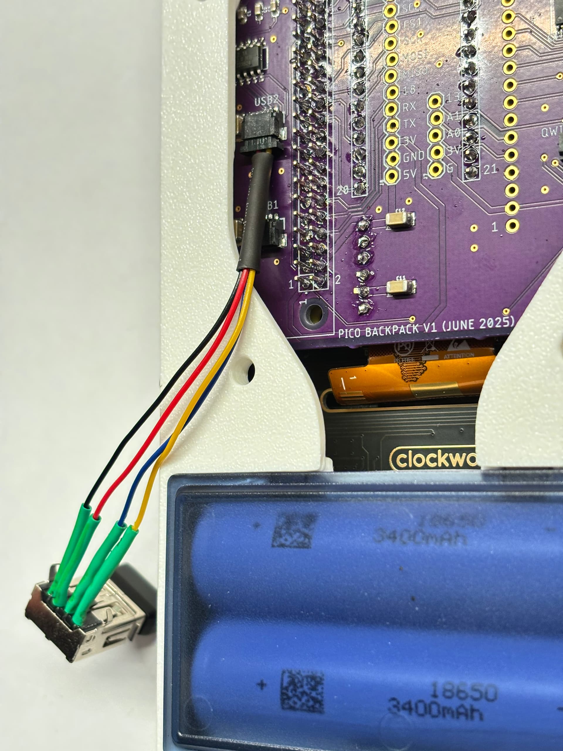

You have connected the usb to go external, this is a nice touch!

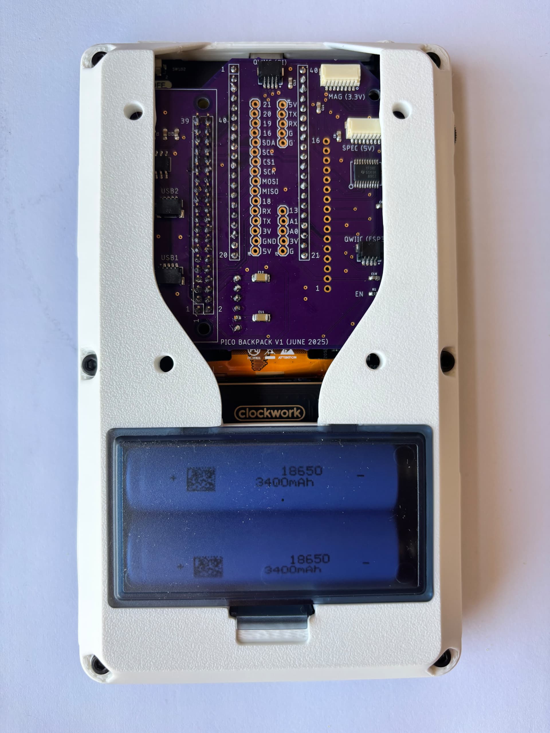

Here is my new hardware, it can be fit inside the orginal case!
Where are you getting power for the zero ?.

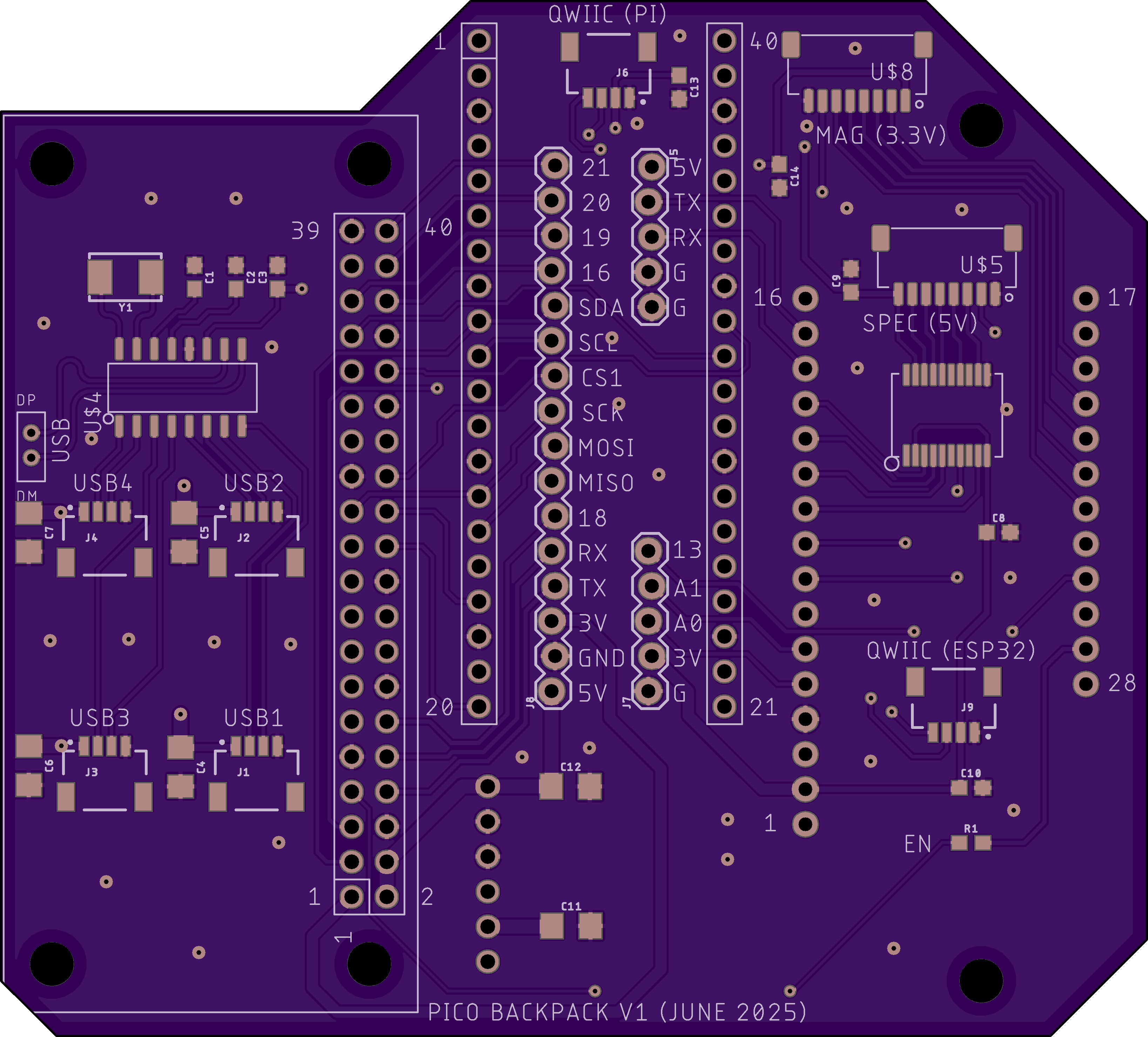

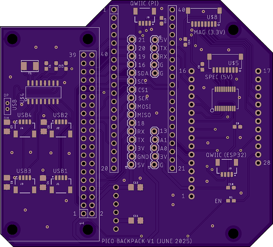

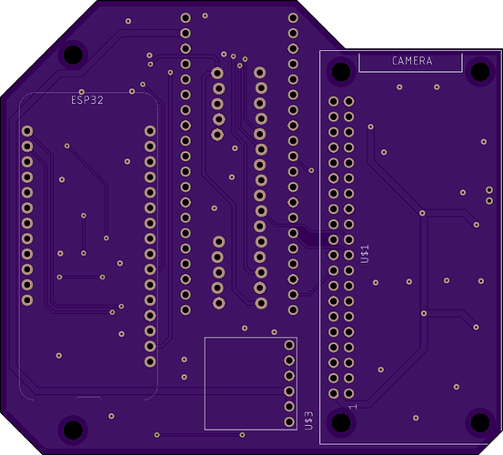

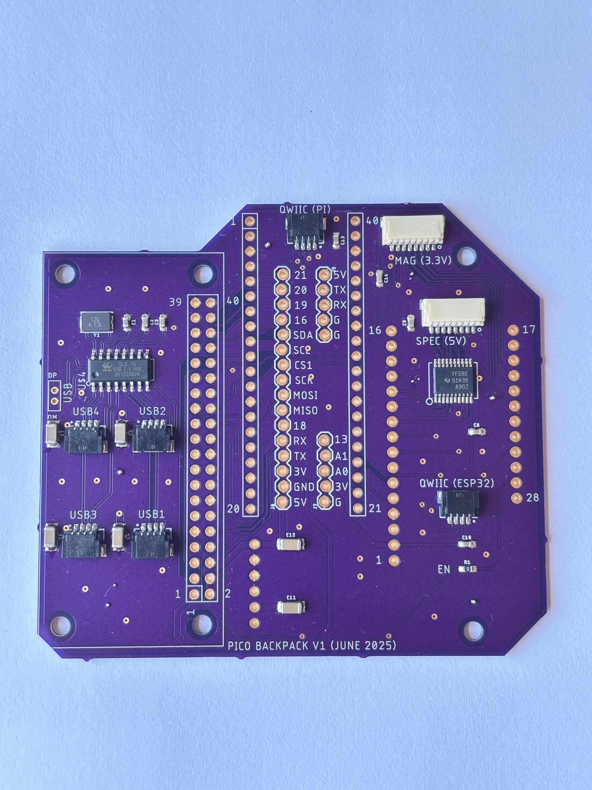

I just sent off a first attempt at an adapter board that includes the following:
It should show up in hopefully ~2 weeks, then I’ll get to build and test it.

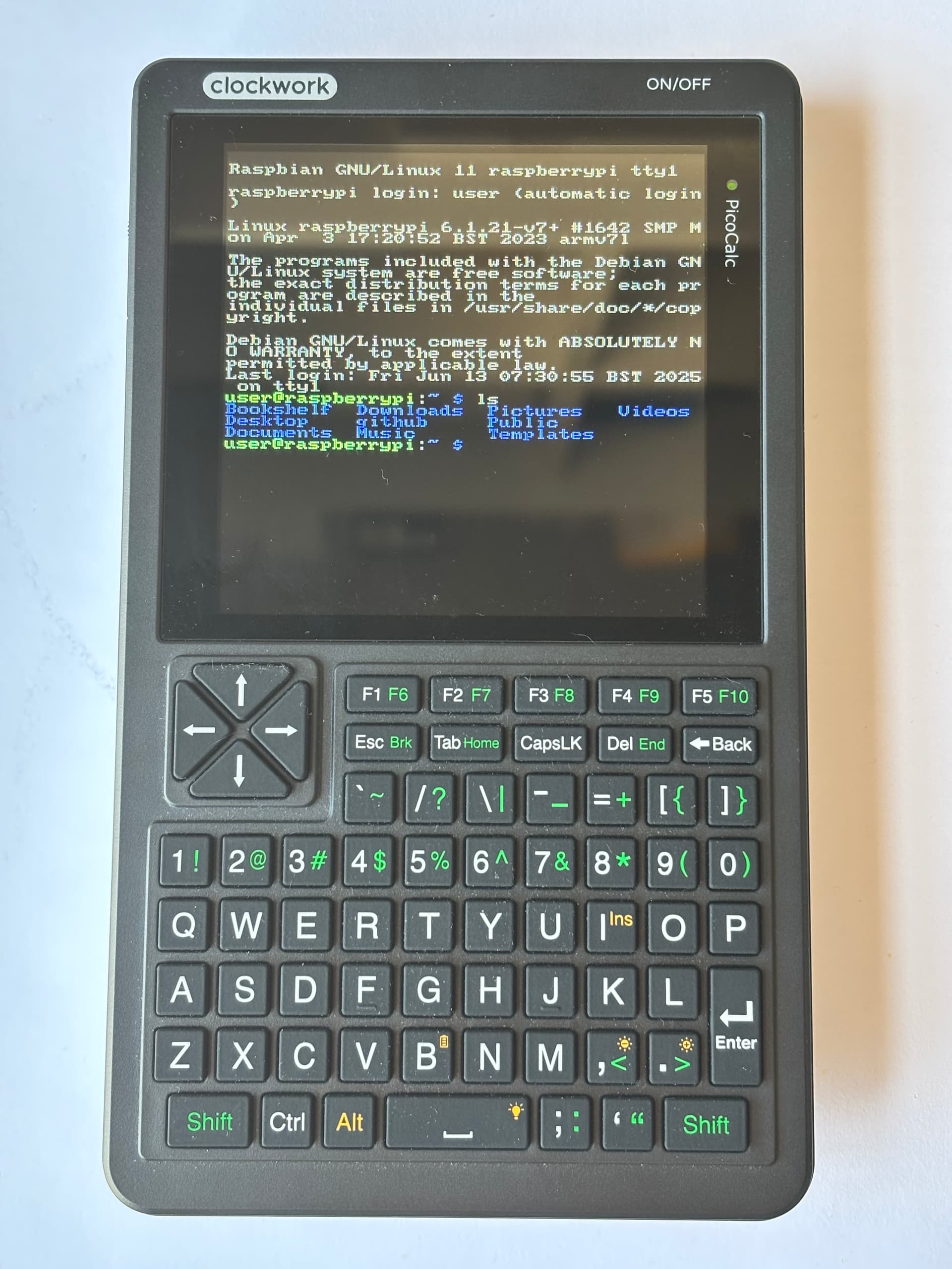

Has anyone figured out how to run dosbox or pico-8 in cli with the pi zero? They run fine with the gui but I like the idea of running everything cli. I get a black screen with dosbox and I have copied the config file from the lyra. When I run the pico-8 I get an sdl error. I’ve started to create a crude bash menu that I’d like to boot up when the pi boots to cli.

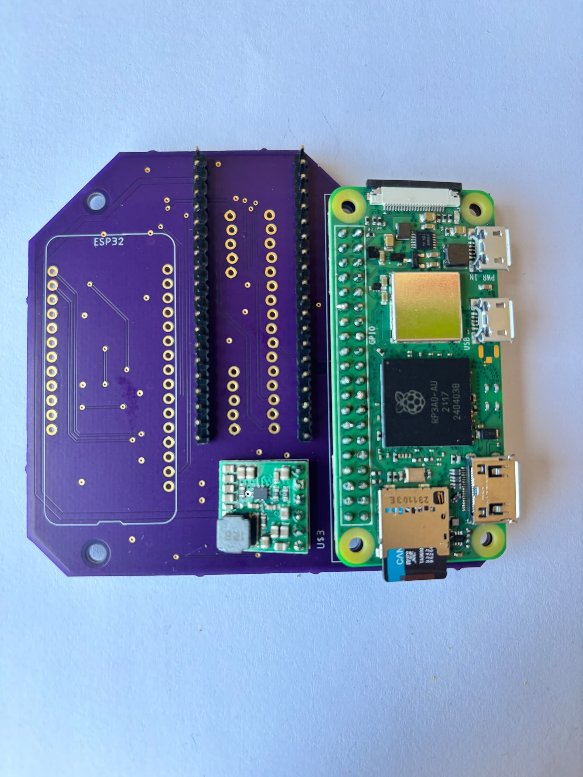

Just a quick update — I’ve populated most of the parts (except for the ESP32), and only begun testing. It does power up, which is a positive sign, but that’s the extent of my testing so far. :slightly_smiling_face:

Another very quick update — the USB hub appears to be working, at least in this very quick test with a mouse — which is great news!

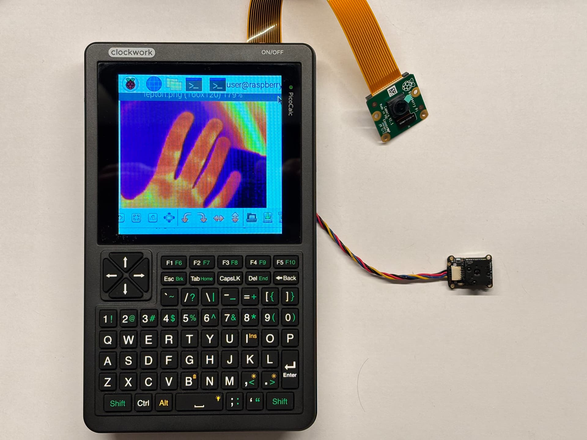

The Pi camera, and a FLIR Lepton thermal camera (connected over the USB JST connector) appear to be working!
