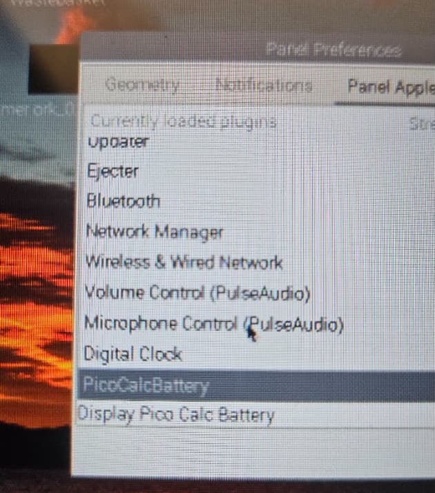

Hi,
Success!
I implemented Battery Meter lxpanel Plugin.
Here we are:
You need to copy picocalcbattery.so to (32 Bit version)
/usr/lib/arm-linux-gnueabihf/lxpanel/plugins/picocalcbattery.so
It is uploaded to Github:
Update: Is now working fine! But only on Bullseye for now.
Remark: It takes some seconds to recognize the plug in and plug out of the charging cable. The plugin refreshes all 3 Seconds but I think it takes the ESP or the Kernel Driver longer to update the battery_percent value.
