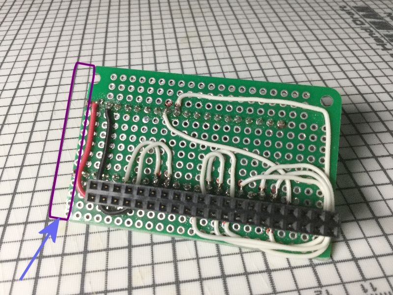

Yes, if you make a relay board for the RasPi Zero using a universal board, I’m sure I can fit it into custom case.
To do this, there are a few conditions:
  1. Cut the universal board to the 24x15 hole size and position the pin sockets and headers as shown in the photo.
  2. Cut the top edge as close to the holes as possible.
    (Otherwise, it will be difficult to fit into the case.)
  3. Use a 2x20-pin socket for the RasPi Zero with long pins, and keep the board-to-board spacing at 16mm.
  4. The cover design for the RasPi Zero is currently a work in progress.
    (It may need some further refinement.)

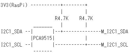

So, basically, I thought about the following:
1). As mentioned above, if I don’t wire 3V3, the I2C SDA and SCL will be connected via a resistor.
That’s strange, so wouldn’t it be better to wire 3V3 to solve that problem?
2). However, if I do that, the pull-up will be too strong, so wouldn’t something need to be done to address that?
3). Since it’s difficult to replace the pull-up resistor to solve this problem,
wouldn’t it be better to use an I2C repeater (such as the PCA9515)?
So, it’s something like this.
Well, this is just my imagination, and I haven’t done any experiments or tried it yet.
I’m thinking of trying to mount a PCA9515 on a RasPiZero2 on PicoCalc relay board and experiment with it.
I don’t know if this idea is correct, and maybe I’m misunderstanding something.

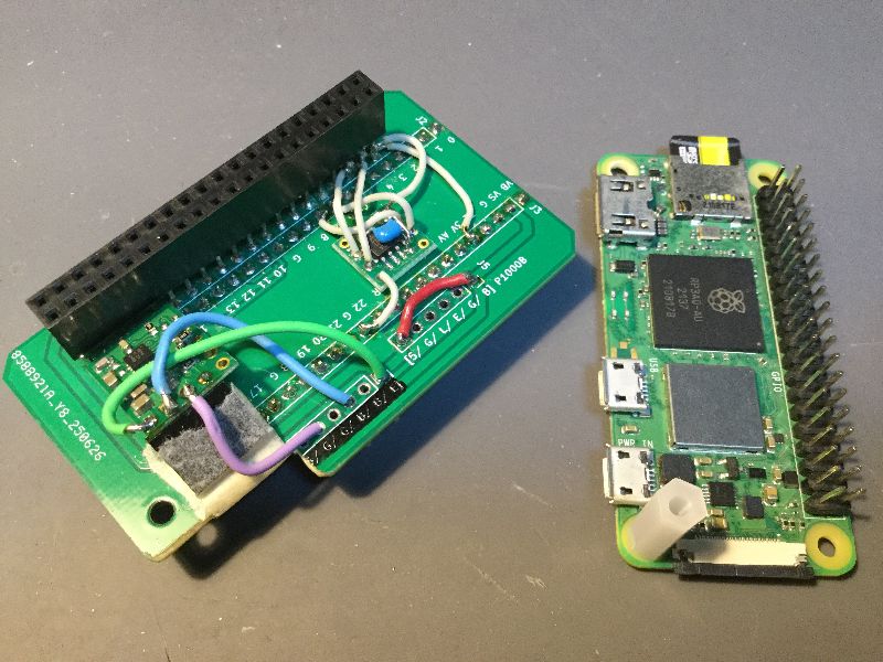

It seems like at this point the only way to get it running is to just install a really lite desktop and either boot command it with startx to just open Pico-8 or just put it on the desktop.
I used an I2C repeater (PCA9515) and a POLOLU Voltage Regulator unit (Pololu - 2.5-9V Fine-Adjust Step-Up/Step-Down Voltage Regulator S9V11MA) to modify the relay board so that it has the following configuration.
For now, the keyboard seems to be working fine, but I won’t know if this is really an effective change until I’ve used it for a long time.
Maybe the keyboard problem I’m claiming is just an illusion.
However, I’d like to think that at least the problem with the I2C circuit has been fixed.
