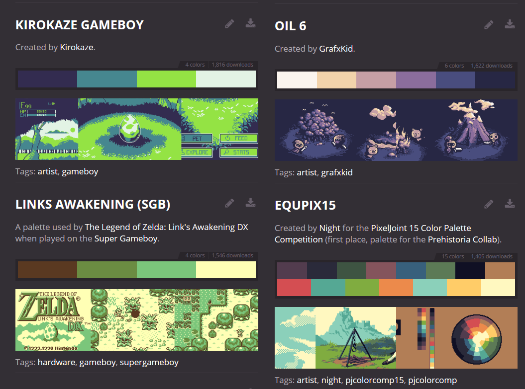

If you’re looking for theme inspiration, Lospec’s palette browser has some great stuff.

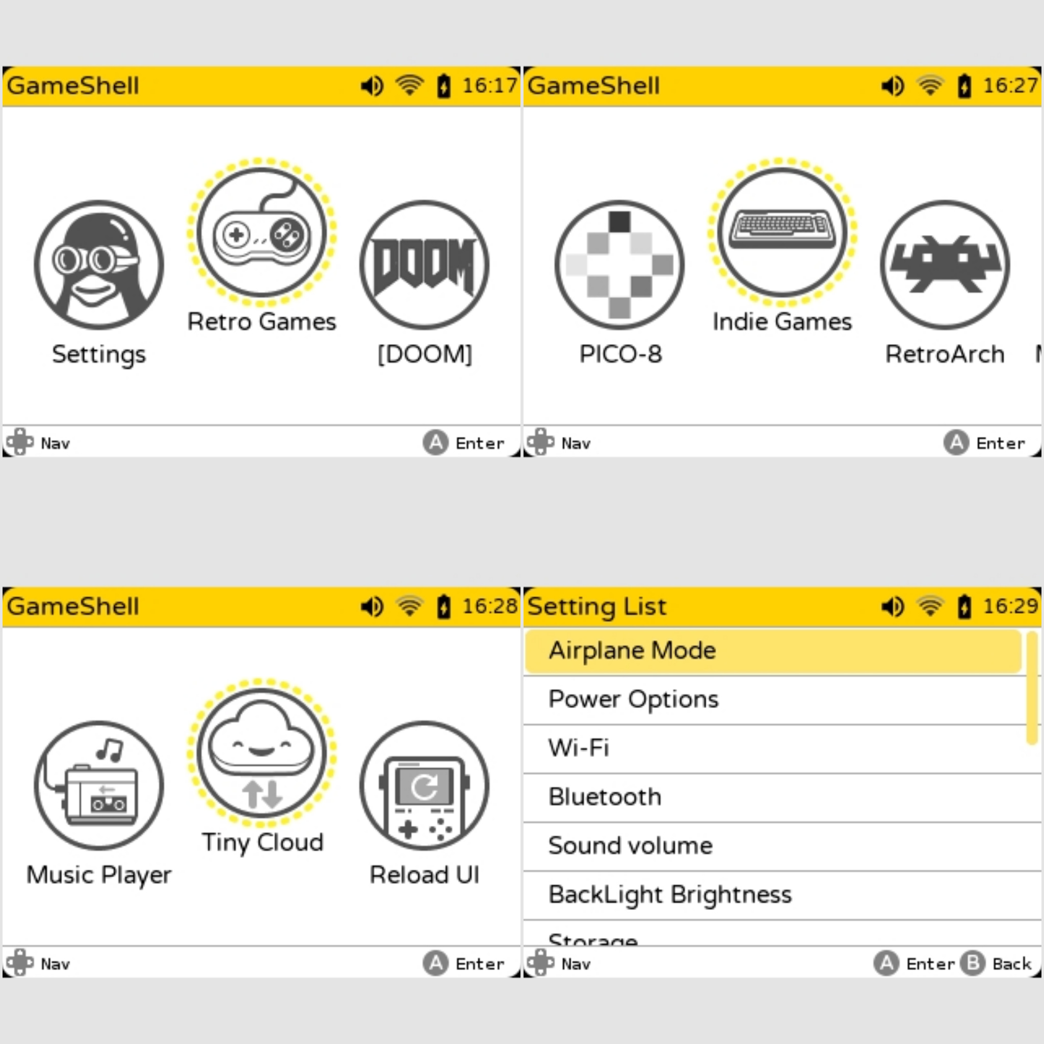

Starting to get the hang of this, I’ve got a yellow gameshell with a yellow skin :slight_smile: 31

Hey! Thanks for all the help on this thread, I’ve done a little tinkering today and I’m pretty excited about the progress. I follow the retro linux scene, and took a template from the RetroFW icon set, along with some color tweaks, and I’m pretty excited with the result!
capture_01
