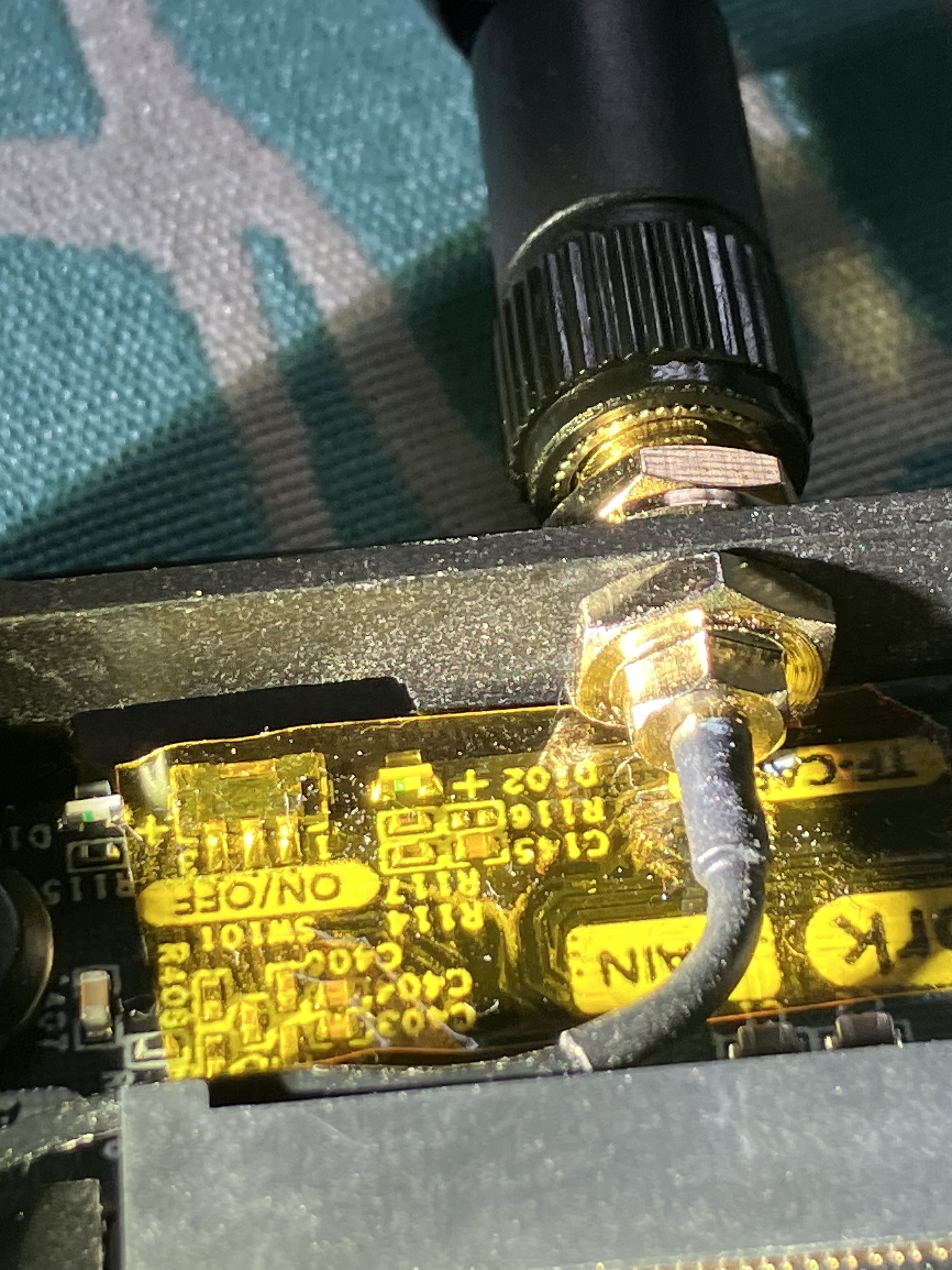

I had to shave flat (grind) one side of the hex base of the SMA connector to fit against the main board, but an antenna squeezes in here just fine in a newly drilled hole.
can you post a pic of the inside, im going to do the same to mine when i get it.
Drilled while almost fully disassembled
Heavily taped and masked
All metal chips blown away
perfect I need 2 antenna up there and one is going by the expansion. Now that i see its possible to fit one over there i’m set. Luckily i’m seeing how others are doing it so i’m going to drill before i put anything together.
Thanks for the pictures!

I put my spectrum analyzer on it yesterday and I can confirm, without dtparam=ant2 in config.txt the CM4 uses the onboard PCB antenna. With dtparam=ant2 the CM4 uses its u.fl (NOT THE U.FL ON THE MAIN BOARD). If you use the u.fl for the clockwork supplied antenna or for an SMA antenna then you need dtparam=ant2. These tests were done on the 6.6.30 kernel
An addendum, if you use dtparam=ant2 and you get worse signal, that might be due to antenna placement. Its not a good idea to stick the antenna directly to the case as clockwork suggests since that will very much mess up the antenna’s pattern and matching. It turns the case into a big capacitive load attached to the antenna. Use a plastic spacer to get the antenna a minimum of 1cm away from the case. Or do what I did and drill the hole in the 4g blanking plate and stick a RP-SMA to u.fl cable there.
