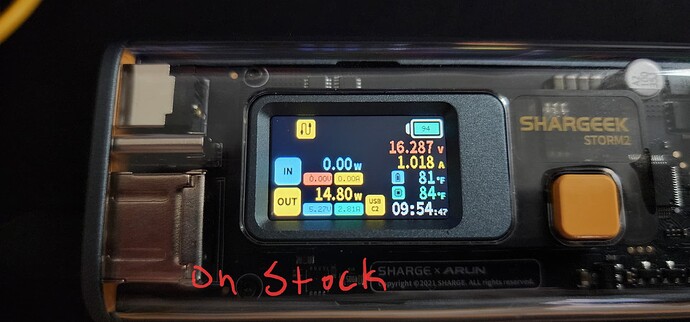

This udev rule doesn’t seem to change anything on the A06.
So if I understand your photos correctly, your saying you get more charge power stock when the unit is powered on, than off? And I guess that changing the current setting does nothing on your core?
The voltages are pretty close to the same. It does vary a bit up and down while charging. And yea, changing the settings do nothing on my a06.
11-14 Watts is already really good. Should be a fine charging speed with that.
Yea, I’ve got no complaints.
