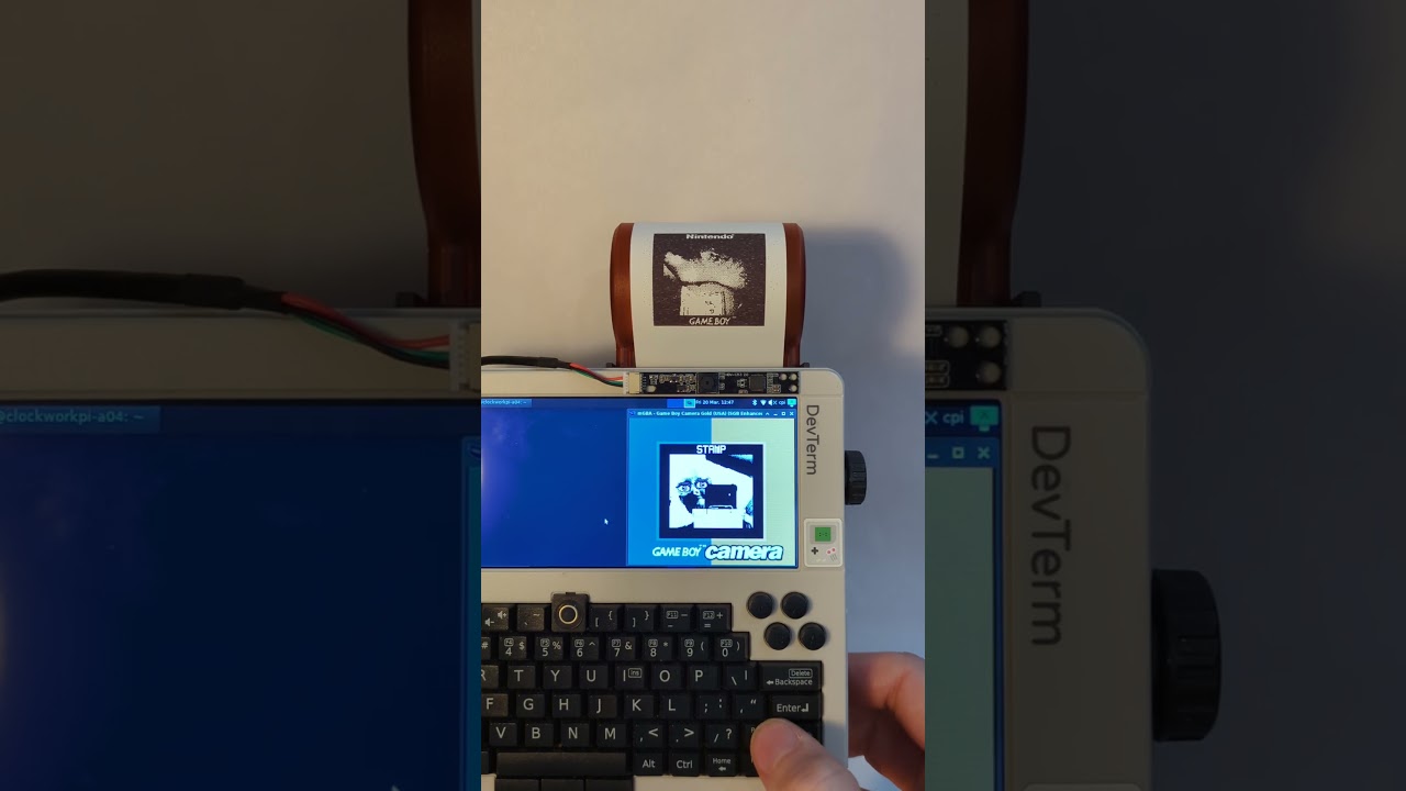

I’ve been using the DevTerm’s thermal printer as a Game Boy Printer, with mGBA running the GB Camera ROM and a cheap USB webcam as the camera sensor.
Getting the printer working took a bit of doing as I haven’t used the DevTerm in a while. My unit was still on the original Hirsute image, so I had to flash the v0.2h image first. After that the printer services came up fine, though the FPC ribbon cable was loose, which caused a “NO PAPER” error that took some strace debugging to track down.
I ended up forking mGBA to add thermal printer support directly to the Qt frontend. When a print job comes in from the emulated GB Printer, it fires straight to /tmp/DEVTERM_PRINTER_IN as an ESC/POS bitmap (no save dialog, no file written to disk, just prints). There’s a settings panel for density, contrast, dithering mode, and scale.
