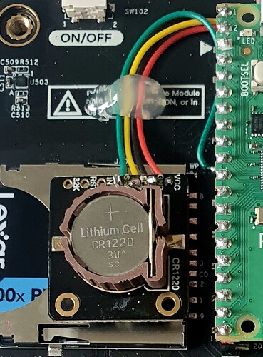

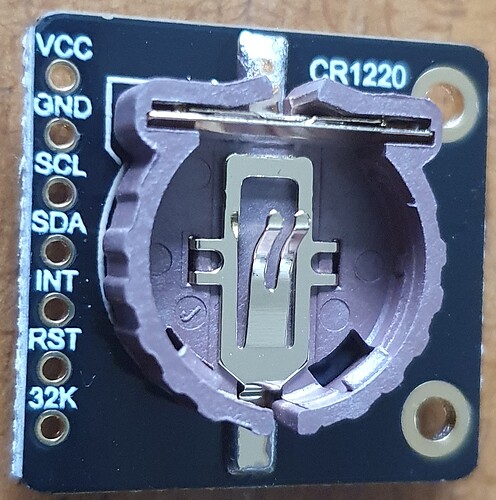

What RTC? There’s so many options.
Maybe DS3231 module with small footprint like mine to hotglue upside down on top of the SD card cage and give easy access to the battery.
DS3231 is very accurate so you can almost forget about it. If you want to play with it there are several calibration registers etc you can access via I2c. Some more expensive varients include battery backed or ferrite ram too but quite slow to access. Note if in a country that uses ‘daylight saving time’ like the UK you’ll have to write an autoboot program to adjust accordingly before setting the Pico clock at startup…
