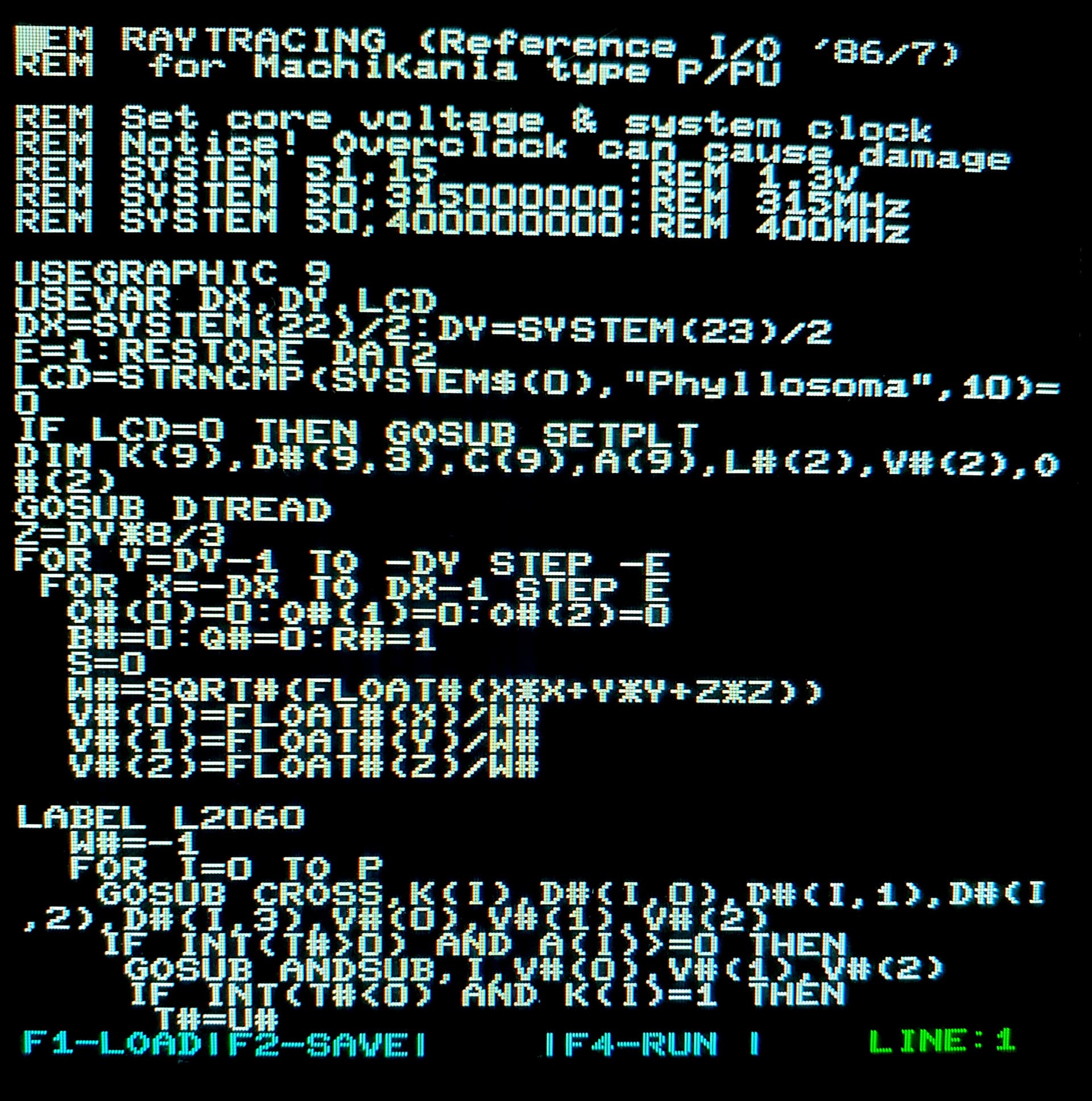

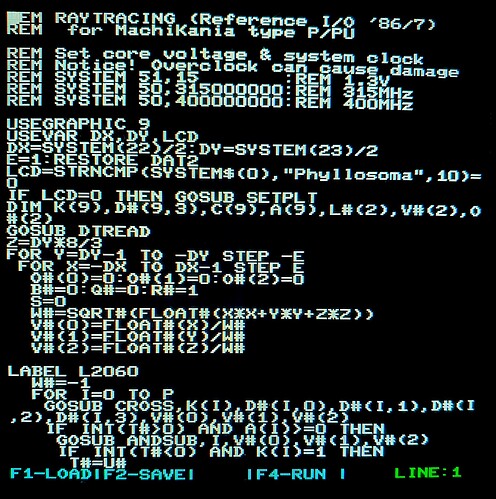

Is there the ability to change clock speed and voltage ?
To use higher clock speed (at 200 MHz as an example):
SYSTEM 51,15 : REM Voltage at 1.3 V
SYSTEM 50,200000000 : REM CPU clock at 200 MHz
