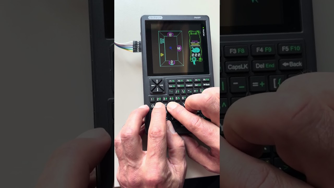

Hi, I’m working on emulating Sinclair ZX Spectrum 8-bit computer on PicoCalc.
PicoCalc, with its color 320x320 display and rubber qwerty keyboard is in many ways so much similar to ZX Spectrum…
And so I have zx-2040 emulator somewhat running now on Picocalc. Main issue is a low-level keyboard driver, or lack of it. I’d love to have it interrupt-based, but I can’t find information how to do it or whether it’s possible. If you have a knowledge on advanced I2C keyboard programming - please contact me.

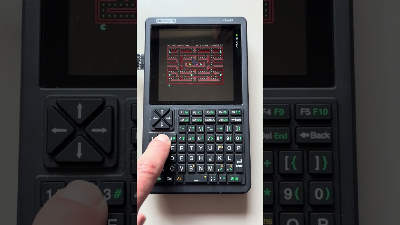

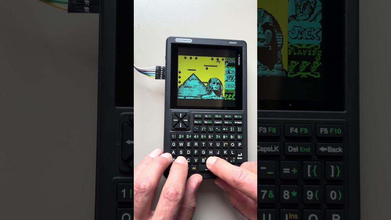

Anyway, here are some Spectrum games I tried:
More information about zx-picocalc project on my blog.
