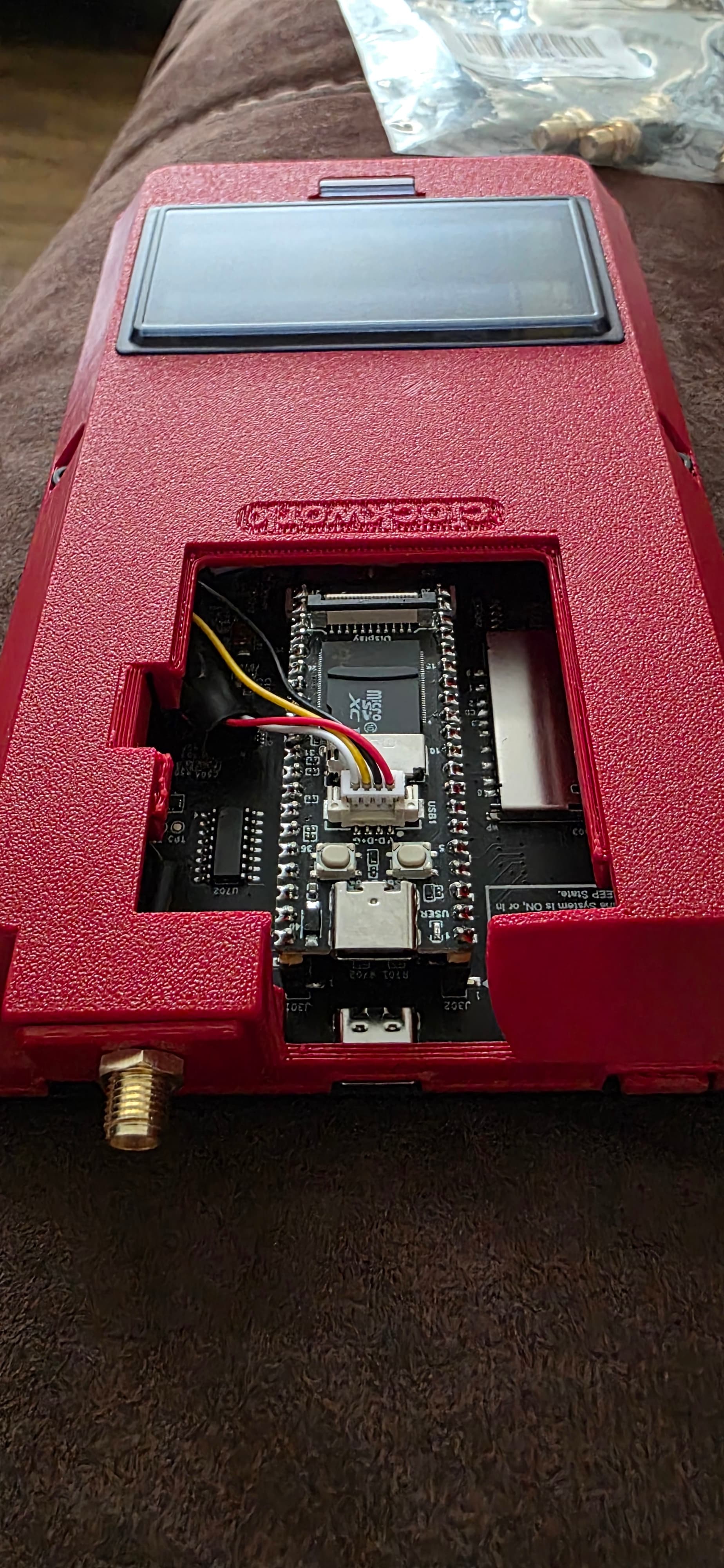

External antenna mod?
Hi yes ready for a majestic setup or lora.
