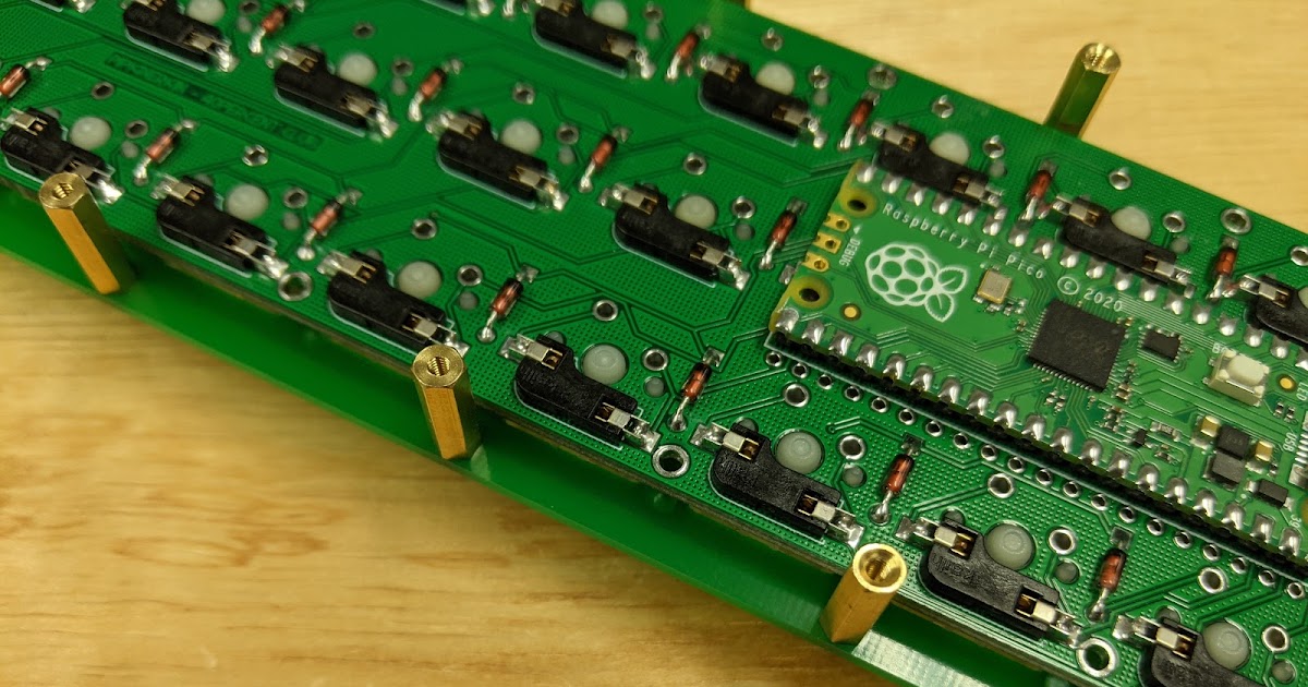

I found a website for some 40% keyboard PCBs. For example,
The size of the PCB is 192mm X 52mm.
I assume that this can be easily modified by making the PCB wider and moving the RPi Pico to the top.

If you want to integrate it in the DevTerm, you will always be limited by its size, so not really gain much I guess. Not sure it’s worth the effort. But anything that can connect to the 4 internal USB pins or a USB connector as a USB HID keyboard should work.

Good point! But the tricky part is the internal USB POGO connector. I don’t know where to find the USB to POGO cable.
Such a “cable” does not exists, you will have to either make it yourself, or make your own version of that keypad with the pogo pins at the right place (and that’s probably the best thing to do so it would properly fit in the DT keyboard slot.
I want to make my own keyboard PCB, but was sad to find the schematics in the repo don’t include gerber files like I (for some reason) expected them to. Does anyone know if there are exact dimensions anywhere for the current PCB, including where the pogo pins need to go?
