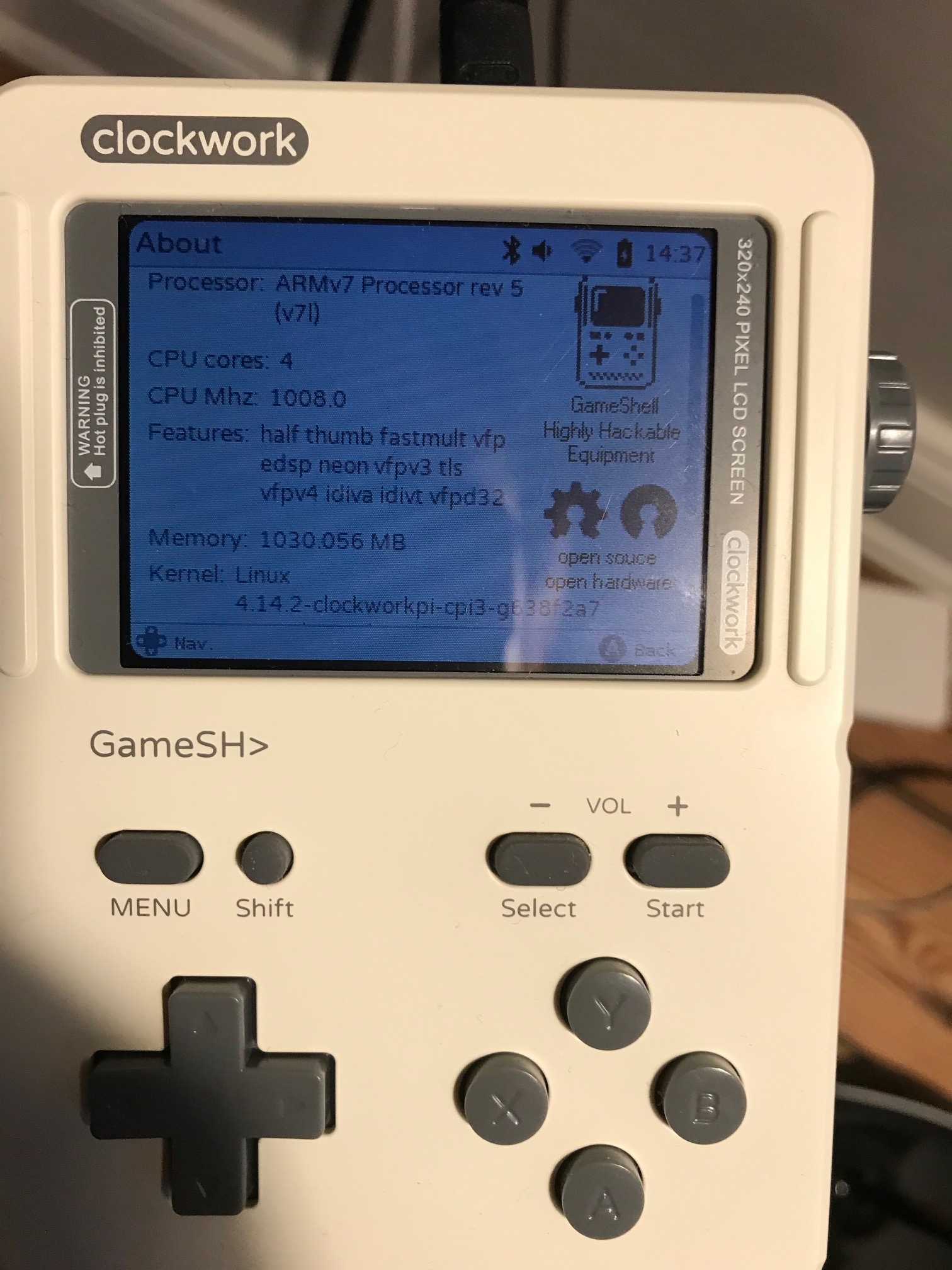

Having same issue, brand new Gameshell (got this yesterday) ; noticed that there were some paths different than in instructions but anyway… might be the new build that is issue…
The instructions were written for OS version 0.1, the launcher path did change in 0.2. I will adapt this in the README.
