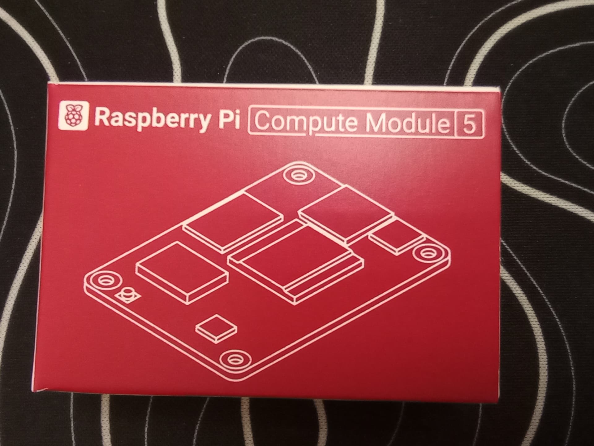

I got a CM5 Dev Kit, wish me luck. Hope to get something working before new year!

Both CM5 on the same day…
Our hero has defeated CM5.
