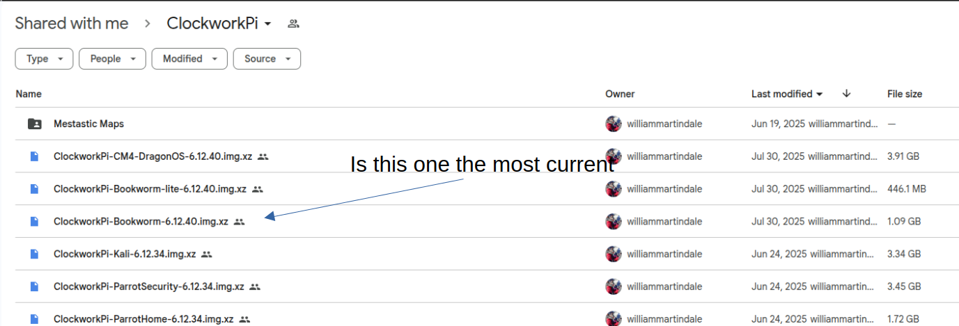

Is this the most current version Rex ?
Yes it is and this is the updated thread for that image.
