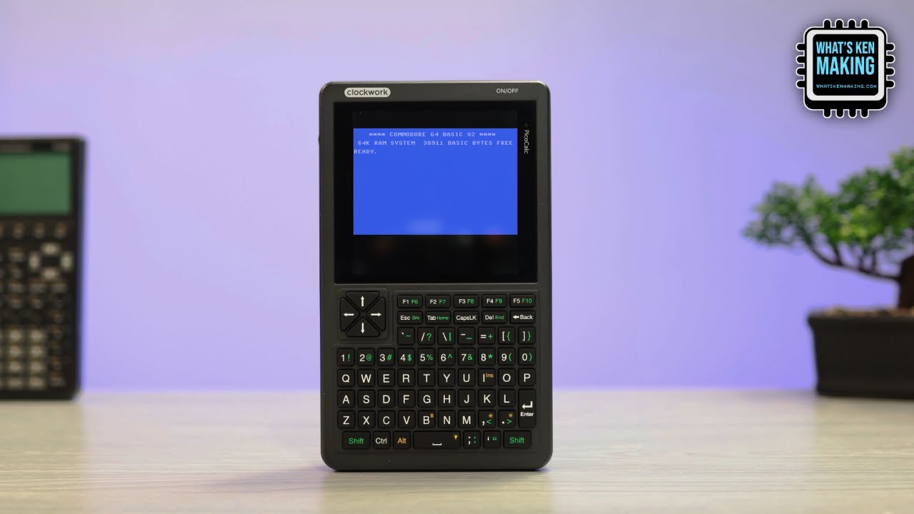

A new Youtube review of the PicoCalc has been posted, the most interesting thing about it is, he started porting MCUME to the PicoCalc, which means soon we will have C64 emulation.

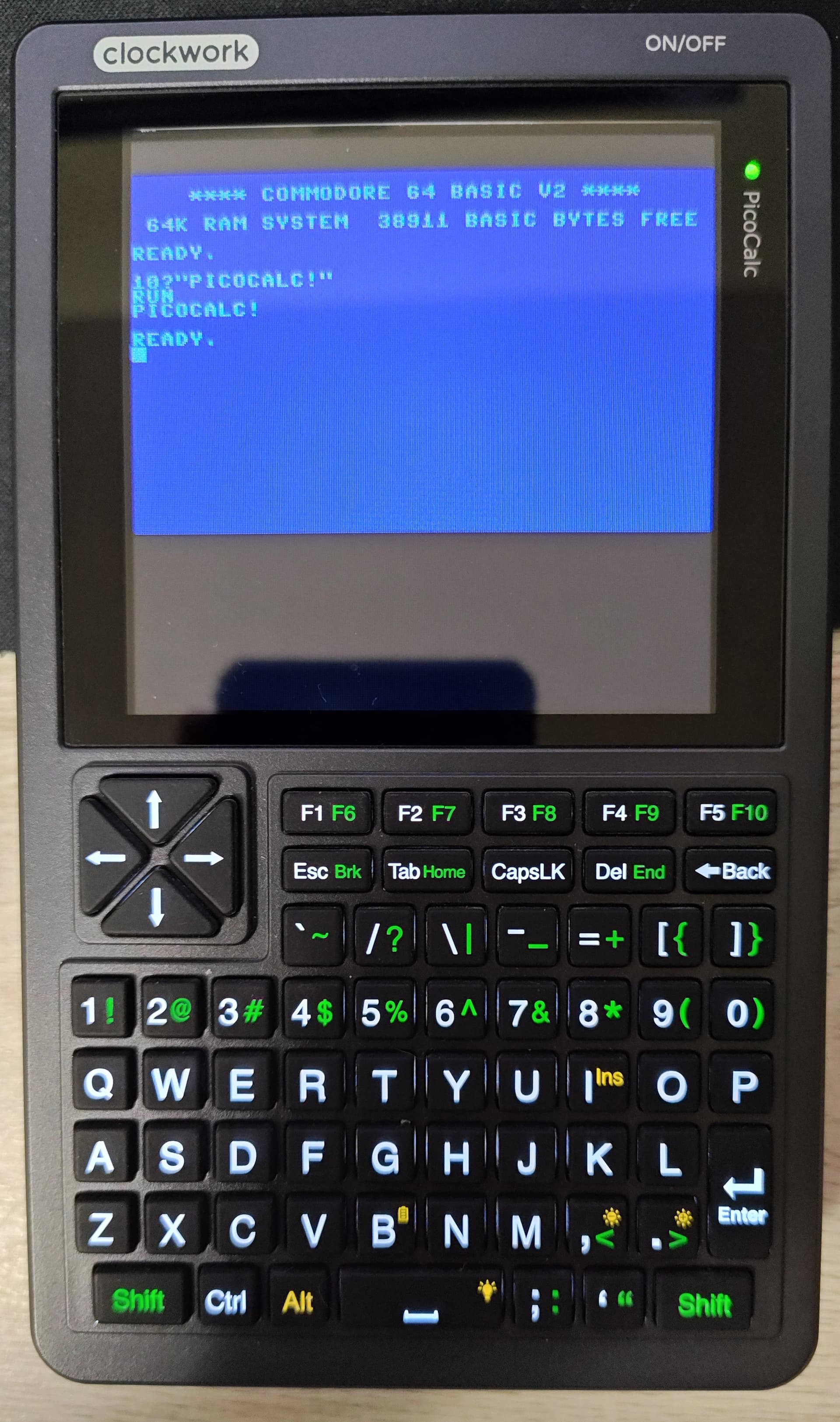

He released a version to github. When i try to load any prg files it just goes to a BASIC prompt and typing RUN does nothing. You can write BASIC programs though.
Yeah, he says in the video that it is not finished yet. I am looking forward to it though.
