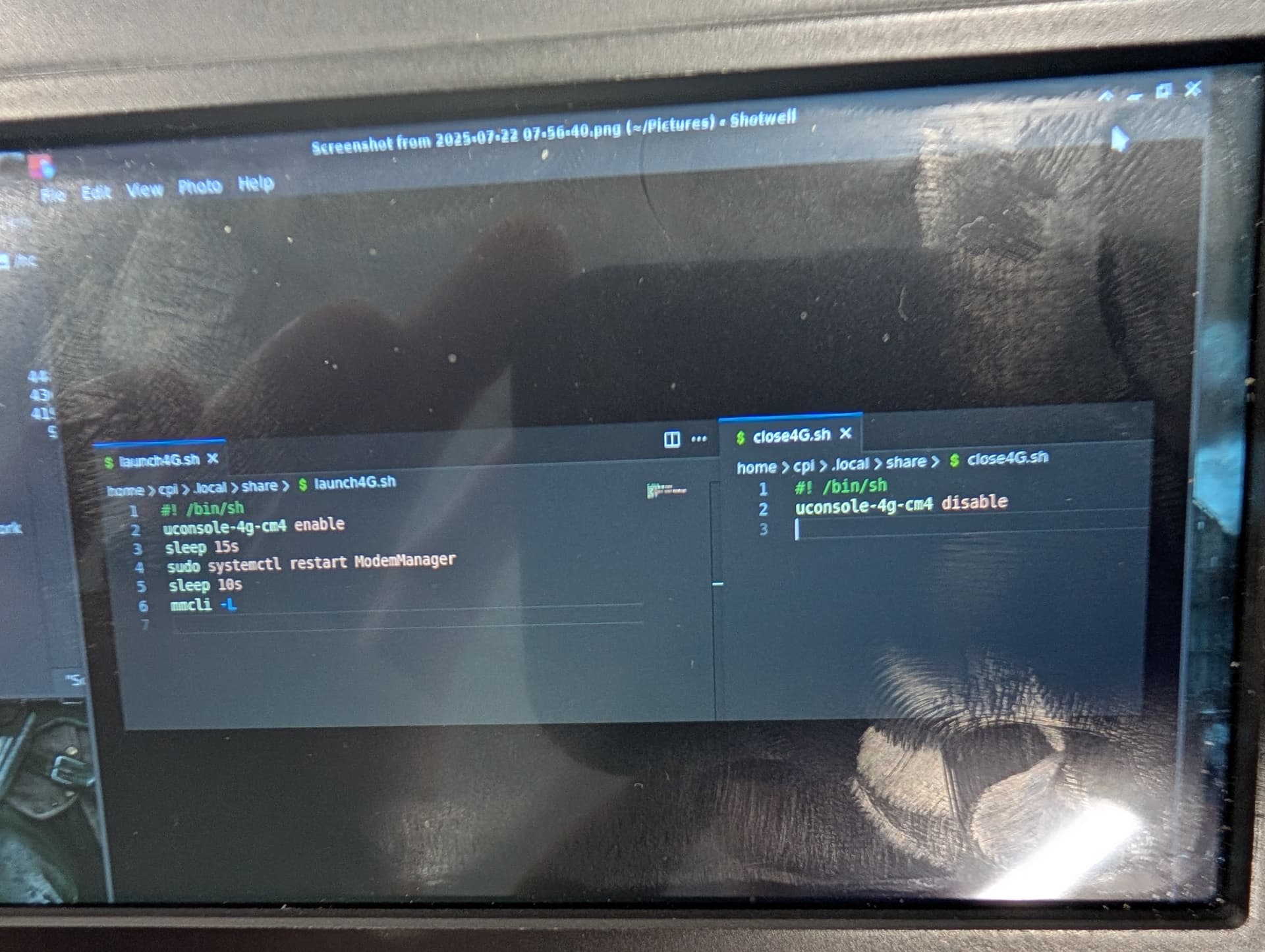

1 because it’s not a daily driver I am running the obsidian image that I customized..
2 I updated my firmware on modem- not required but it changes the way it interacts with the OS.. I wanted to update.
3 gotta run “uconsole-4g-cm4 enable” when ever you want to post it on..
4 after waiting 15 seconds for a power on, then you will need to restart ModemManager service with “systemctl restart ModemManager”
5 then wait another 10 seconds and run “mmcli -L”
I put all that in a bash script that I run from my start menu… And then just disable it when done…

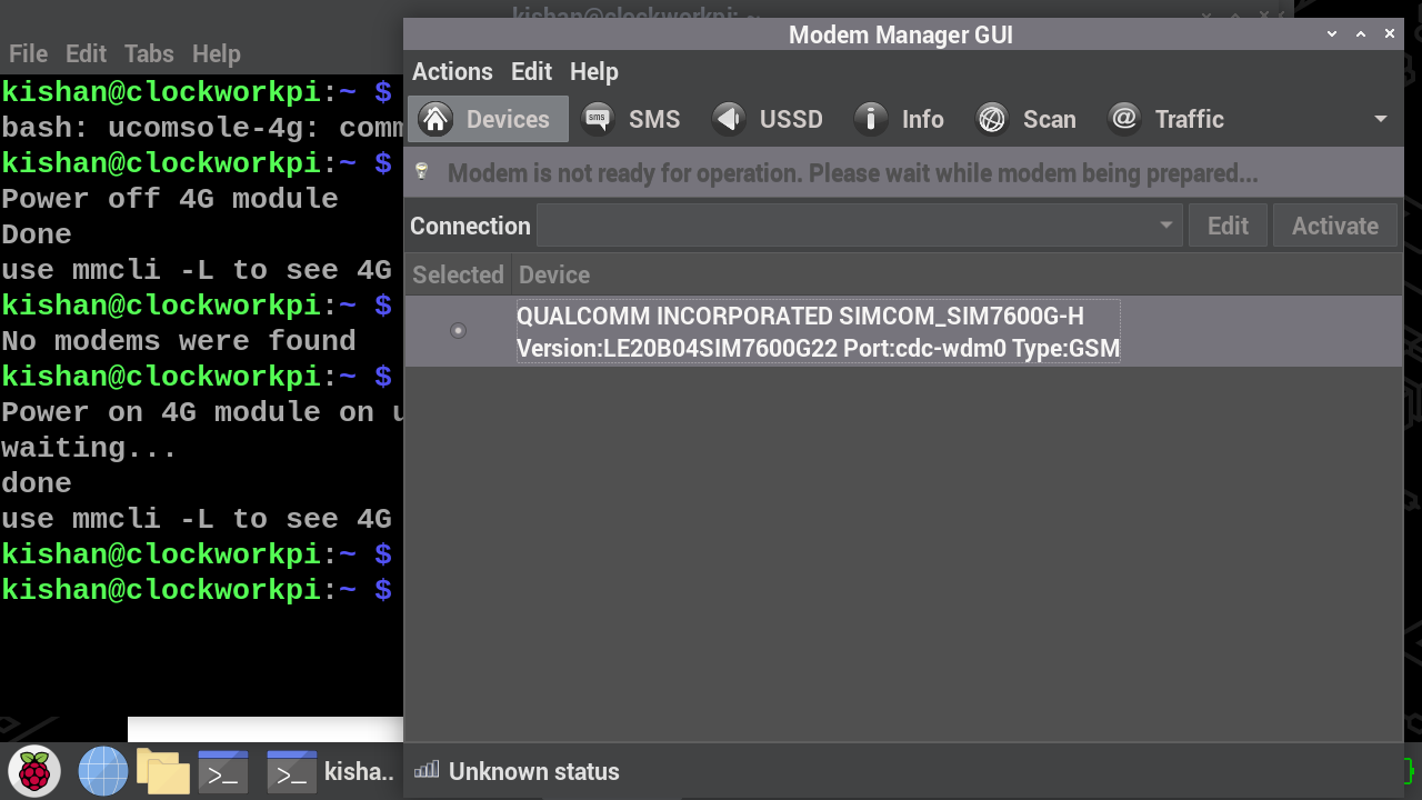

So this is where I’m getting stuck. I can run commands above, though I have to use uconsole-4g enable (uconsole-4g-cm4 enable does not work for me, for some reason). Otherwise commands seem to run OK, however, my Connection never comes up:
I’m not sure what I’m doing wrong. Is it possible my SIM card is not seated correctly, or something else going on that I’m not doing correctly?

what does your ‘sudo mmcli -m 0’ say
the “modem is not ready for operation” means you are not even at the point of looking for service yet…
the screenshot you are showing, states they prefer the ttyusb2 which would require the firmware swap… thats why you see cdc-wdm0 in your port info for the modem.. you can try blacklisting the kernel modules if you want… like they suggest trying.. but we need to see what modem manager is actually picking up from the modem in the cli first…

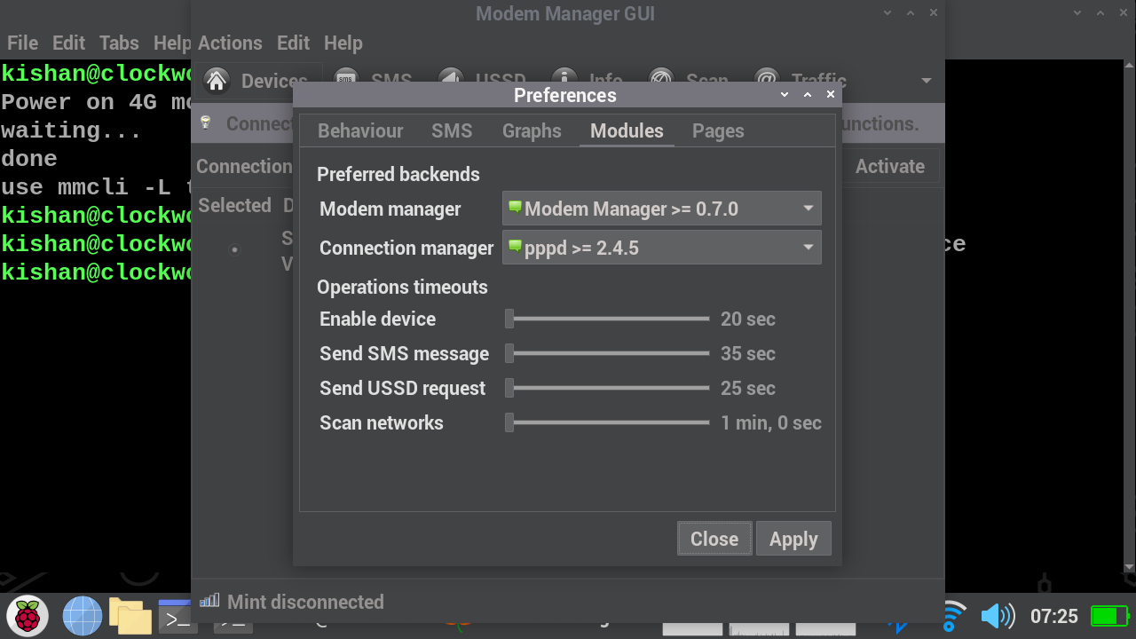

i think I’m getting a little closer. I cannot figure out how to use standard APN profiles. I used the manual command but it keeps asking for a gsm password:

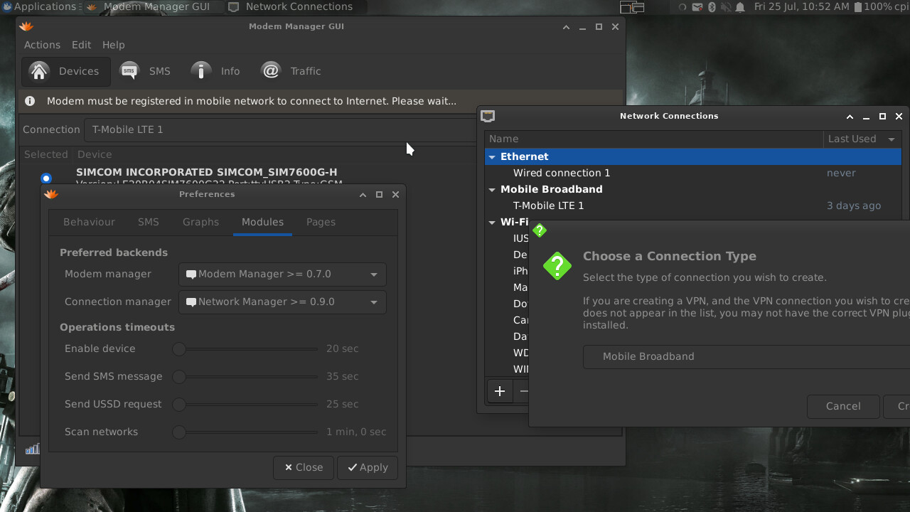

awesome, you are closer.. now we have to deal with your connection manager not being set up right… open up the modem Manager GUI with the 4g card running, hit CTRL+P and click the modules tab, personally.. I have modem Manager >=7 for modem Manager, then connection manager, I have network manager >= 9oint is, whatever you are using in the connection manager slot, ain’t working. usually when you do first run you have to select those manually… maybe that didn’t get selected…
as seen in pic, dont command line your connection, if it shows up in mmcli -m 0 just use the network manager wizard to create a t-mobile profile… then restart modem manager and it will pass it over between programs

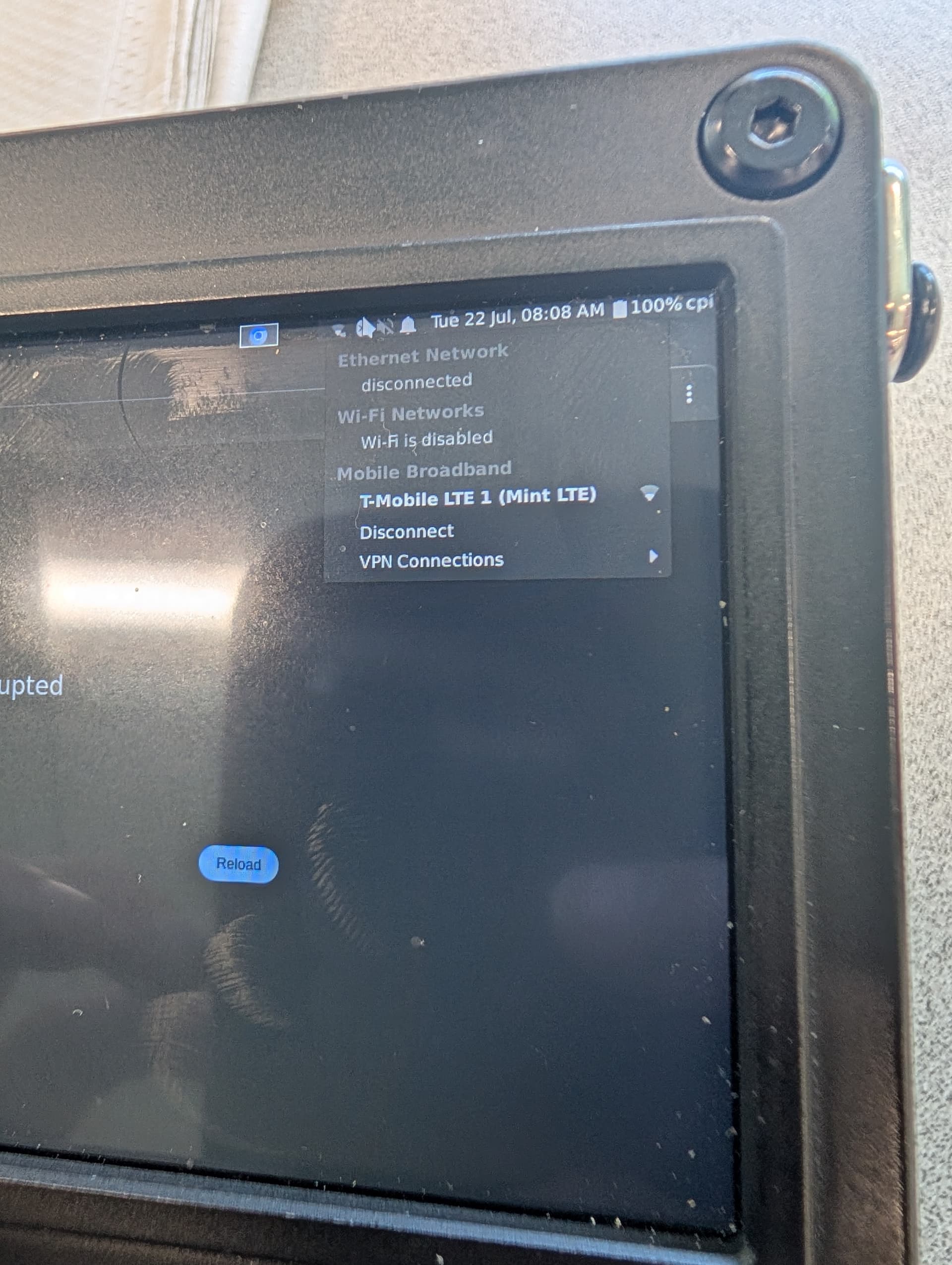

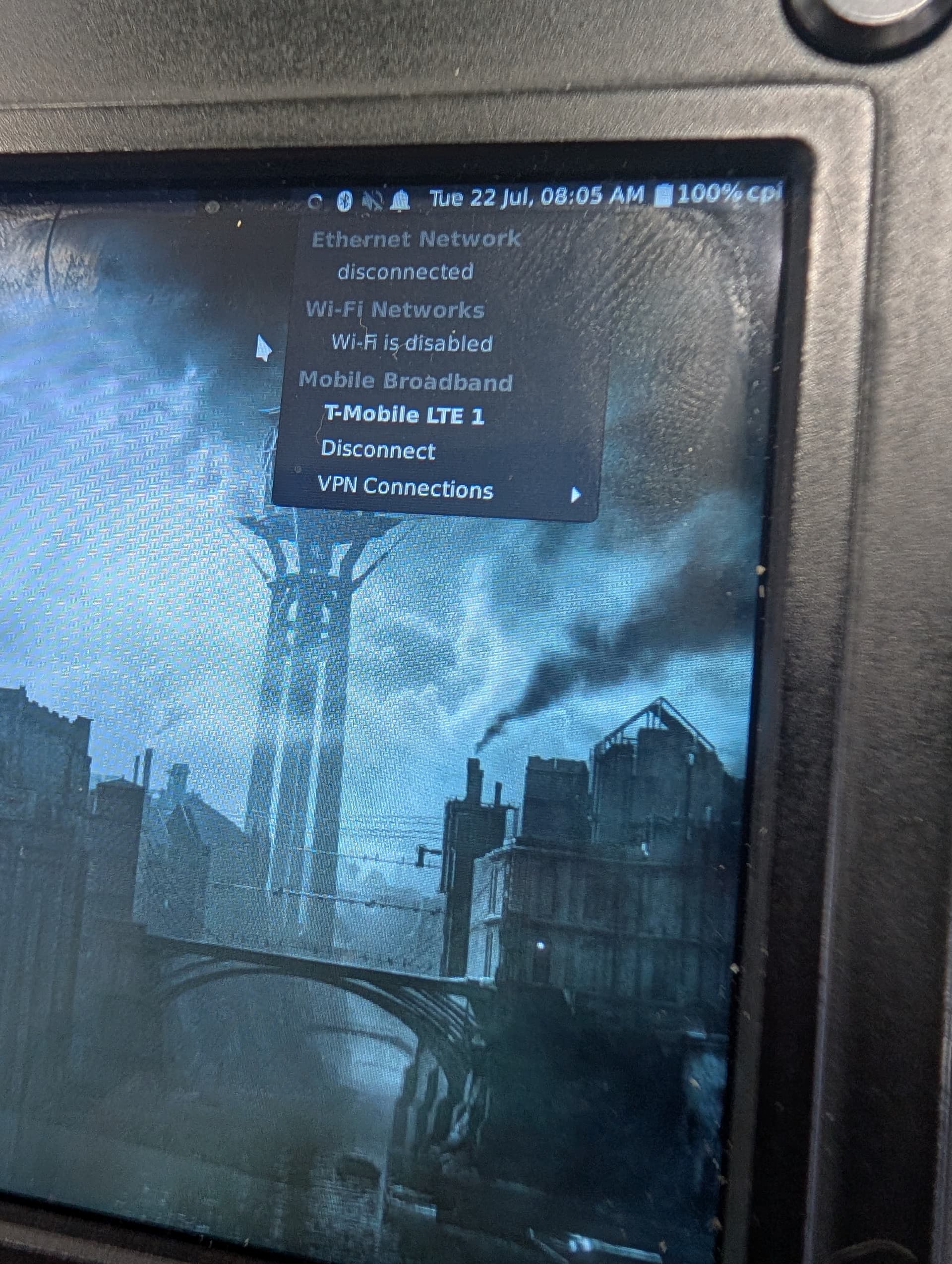

OK, it seems like I’ve got even closer, since it now shows a Mint connection. I think part of my problem before yesterday was my SIM was not seated corrected, as I had to get an adapter for the nanoSIM to get it to sit properly in the SIM tray.
Though not sure how to switch to Network manager as the Connection manager, as I do not have that option:
In simple terms, install network manager, if everything goes well, it will auto switch your uconsole to use it and you will just have to restart mmcli again to add it to that list… If it doesn’t go well, you will have to manually back track to get any Internet access back… Usually through pi setup app… There is a old post on here about loosing wifi after updating that tells you how to reenable DHCP… That should bring things back if you fail… Also if you decide to uninstall your in use network manager… Doing things like this is your own risk… Cause it may act different for different OS. On mine it swapped fine

the names are convoluted… nm is network manager backend.. you are talking about network-manager -is the GUI front end I believe.. you are using conman to manager your connections… you can try selected it.. it is not what I use.. point here is it will never work with pppd - because that is just point to point communications…
