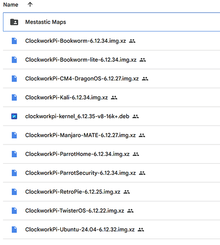

I do have a final question for the group. Does the setup of the cellular expansion card only work with the Bookworm image, or can it work with the other images in the uConsole repository?
It should work for all of them. The package is only available from the Debian and Debian based distros. Manjaro you’ll have to download the package and extract it to use it.
$ deb2targz
Where do I find the cellular package? Thanks!
In the mega link in any of my distro threads or on my GitHub in my clockworkpi-apt repo.
Great and I’ll check out those threads. Thanks!
So I’m going to try to apply your package to the DragonOS distro. Is it correct Rex your package can be found here, and can it be installed simply by running the commands you’ve listed? Thanks
Yep just do sudo apt install uconsole-4g
