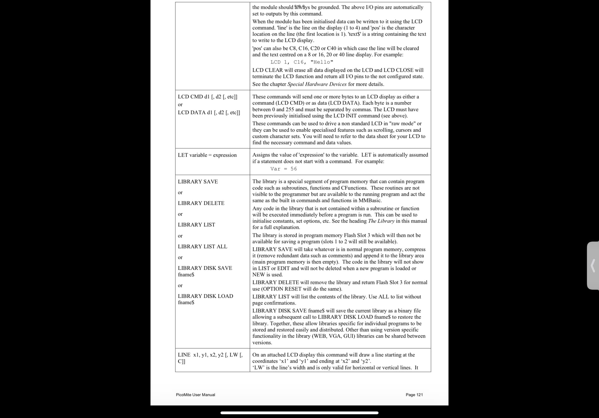

Enter “library save”
Then “library list” to confirm it’s there.
That should then run before every program…

Do you know the command to remove something from library? or do i have to reflash the pico?
Library list
Will list the functions you have created in library flash 3
Library delete
Looks like it deletes all of library in flash 3
I do not see a library edit

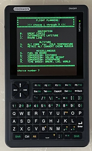

That is what I am developing for this PicoCalc. The program is now up to 25K in length which they may not get longer depending on how I enhance the output and decrease the coding redundancy. MM basic is new to me as I am used to HP basic with much less GUI interface, but more scientific functions.
There is no library edit function. Keep a copy of your library in BASIC format and whenever you make a change to it, make sure to do a SAVE"yourlibname" BEFORE you do a LIBRARY SAVE or else you won’t be able to see your changes in the BASIC program since LIBRARY SAVE deletes the program from the edit buffer as it copies it to the library.

‘library save’ will ADD whatever is in the program buffer to the current library contents !. See the effect with ‘library list’ after a few saves. If you want to update the whole library contents and not add to them you must ‘library delete’ before ‘library save’ !
I just have ‘option angle degrees’ in there and set it by simply entering it into the editor and exiting with F1 before ‘library save’. I may add useful subroutines and functions in the future when program space reaches limits (hence freeing program space)…
