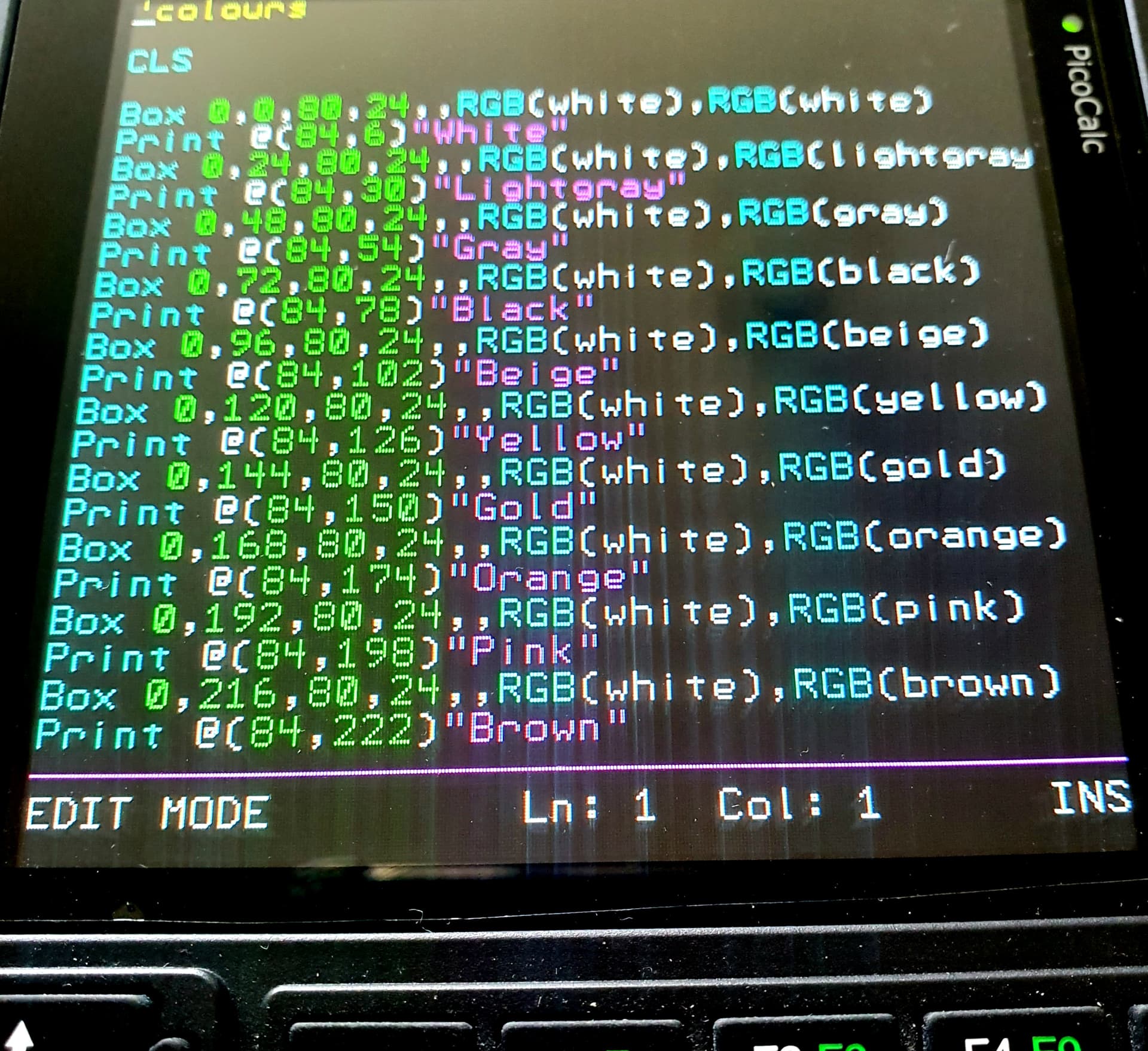

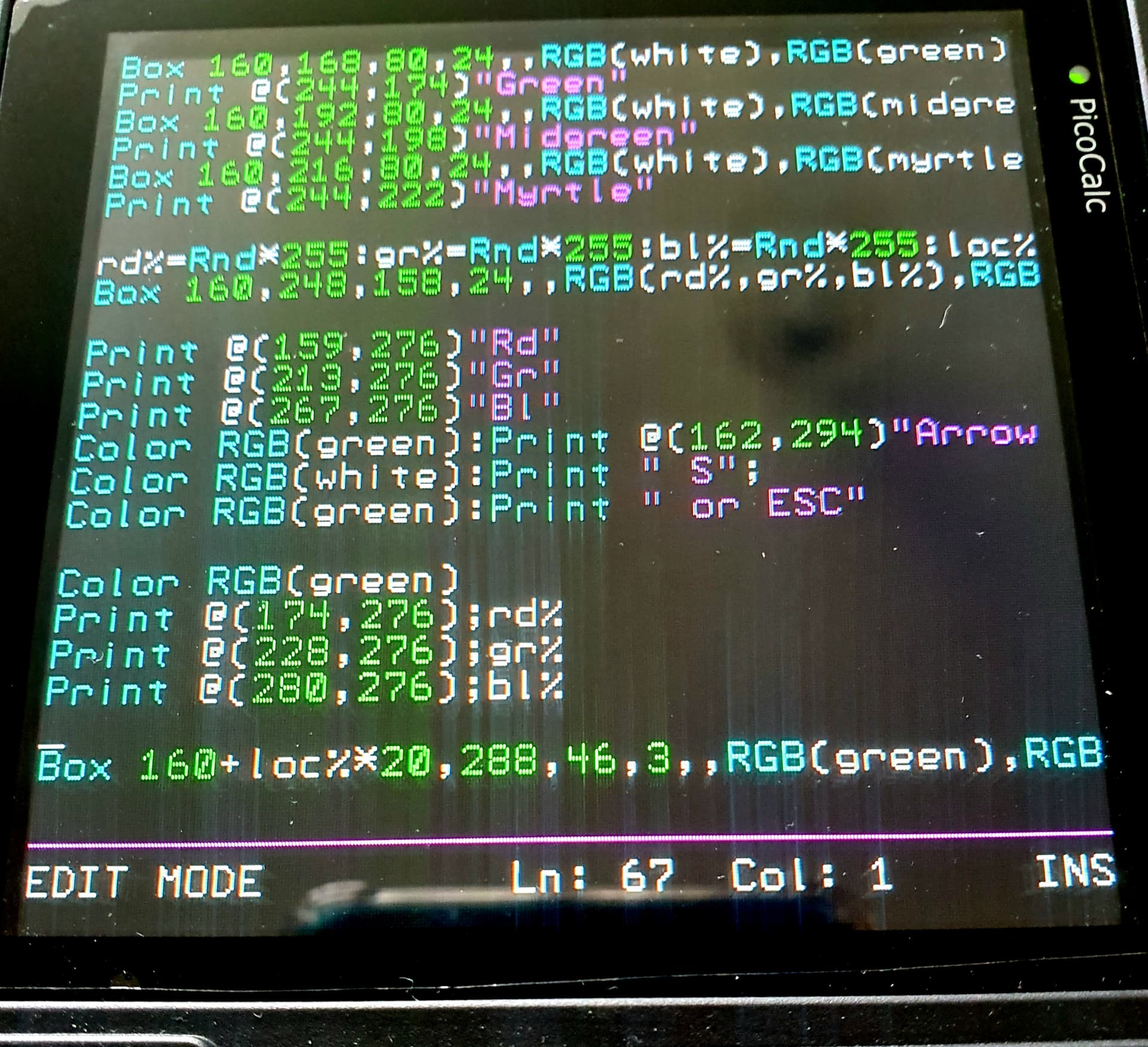

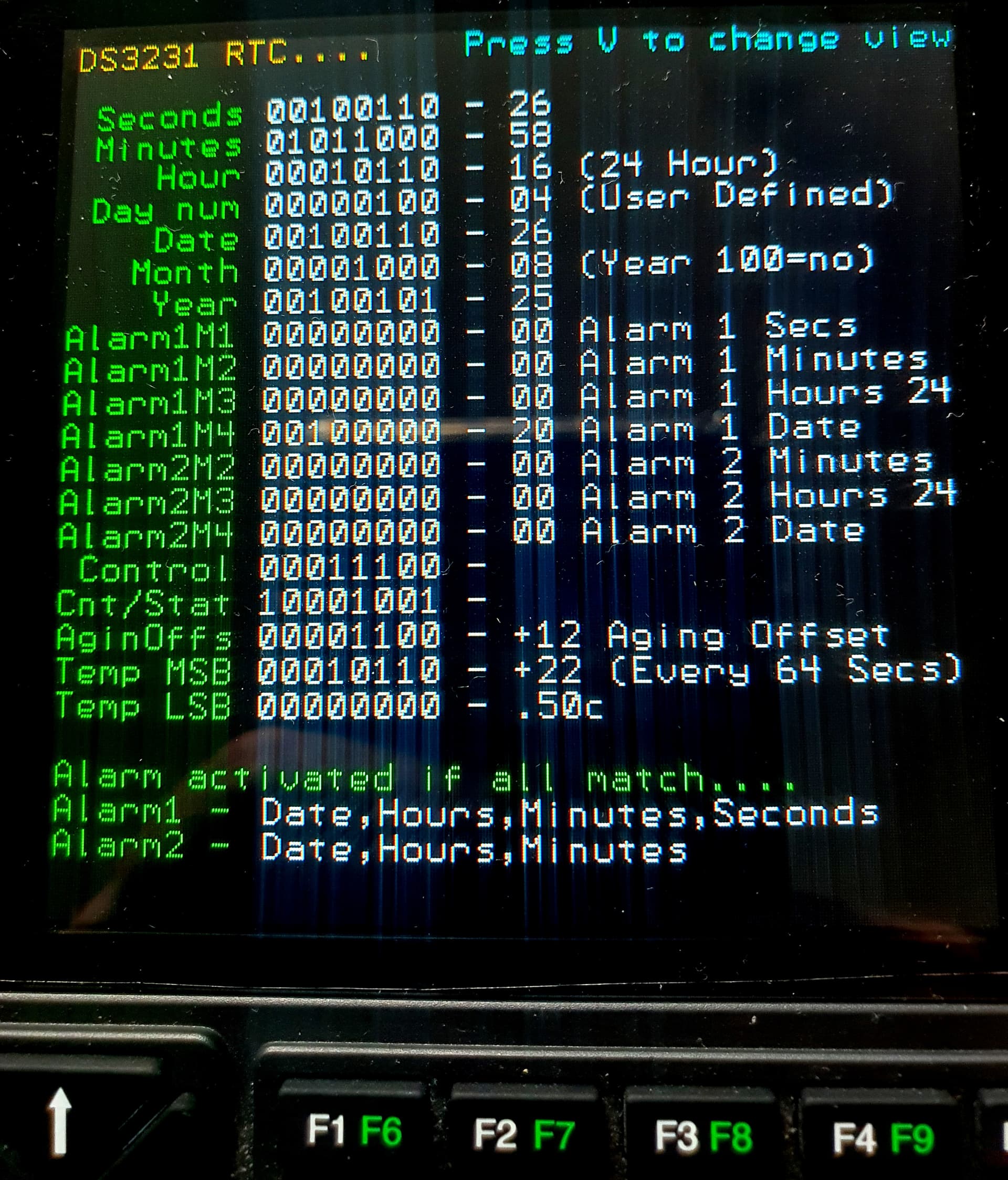

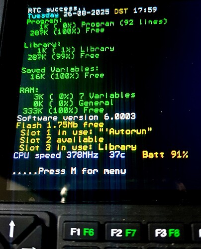

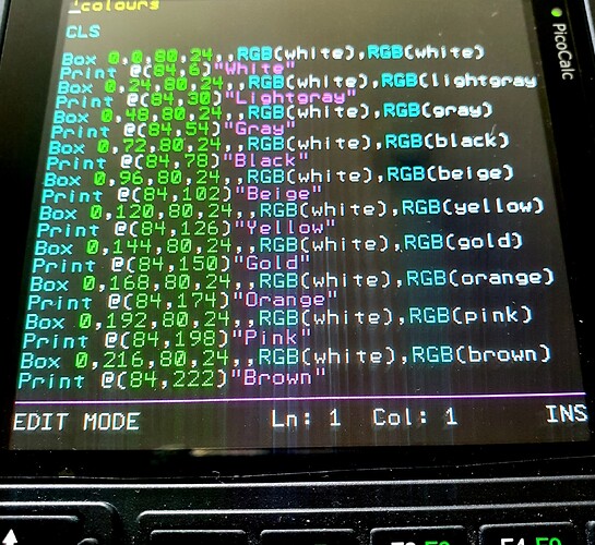

A few examples of colour via MMBasic….

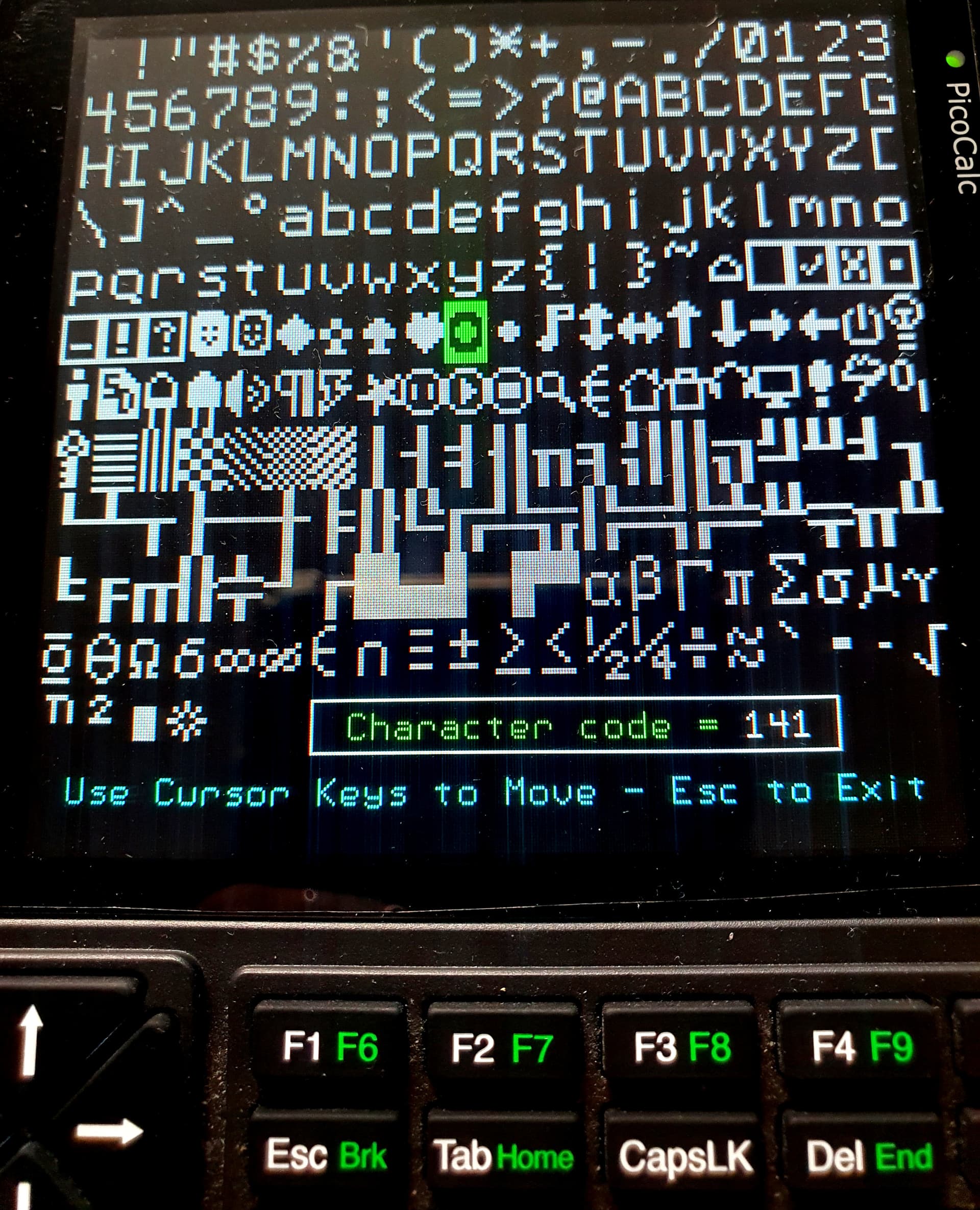

Would it be possible to get the code for this “font viewer” program (3rd screenshot)?
I end up having to go into the documentation and manually calculating which character corresponds to which character code so many times… :stuck_out_tongue:
Thank you.
Absolutely, you may wish to change the last line as returns to my menu program. Note the first character beeps to remind you it’s a black box, not green !. Formatting lost copying from Windows :upside_down_face:
