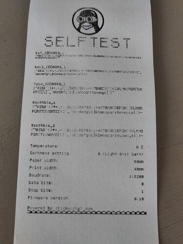

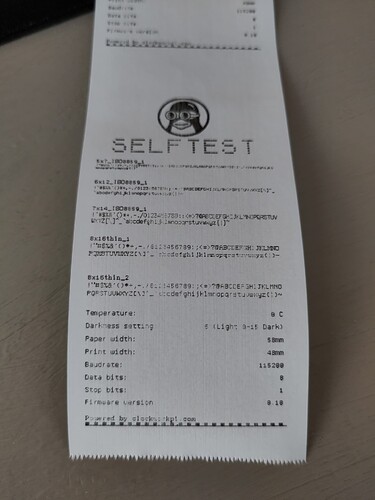

Incidentally, could you send a picture of your test print?
In particular, I’m curious about the last "checkerboard pattern, which seems to be quite wrong on my printer…?
These are two test prints I made: it looks like when a line that is supposed to be fully black, the paper isn’t advanced at the right pace? Not 100% sure, but noticed that on other test prints with full-black lines that I tried to make.
Cheers!
its ink blobs on the printer head, you can clean them with a cotton swab and alcohol
