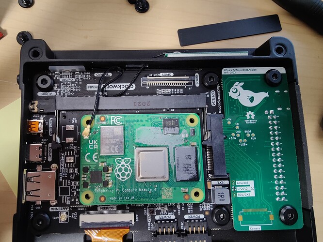

One thing you should do is curl the cable of your antenna on the inside of the console so that it stays near the opening near the top of the case as much as possible. You want it 1-2 loops so it is loose and stays near the GPIO port. This is so it doesnt run along the side of the mainboard or across the Pi which lowers the antennas reception a LOT. Just as a note the connection will still be crap with this change, just slightly less crap.
Example (note I am not using the default antenna, but the cable position still helps):

  • Re-routed the antenna as in your picture, didn’t work
