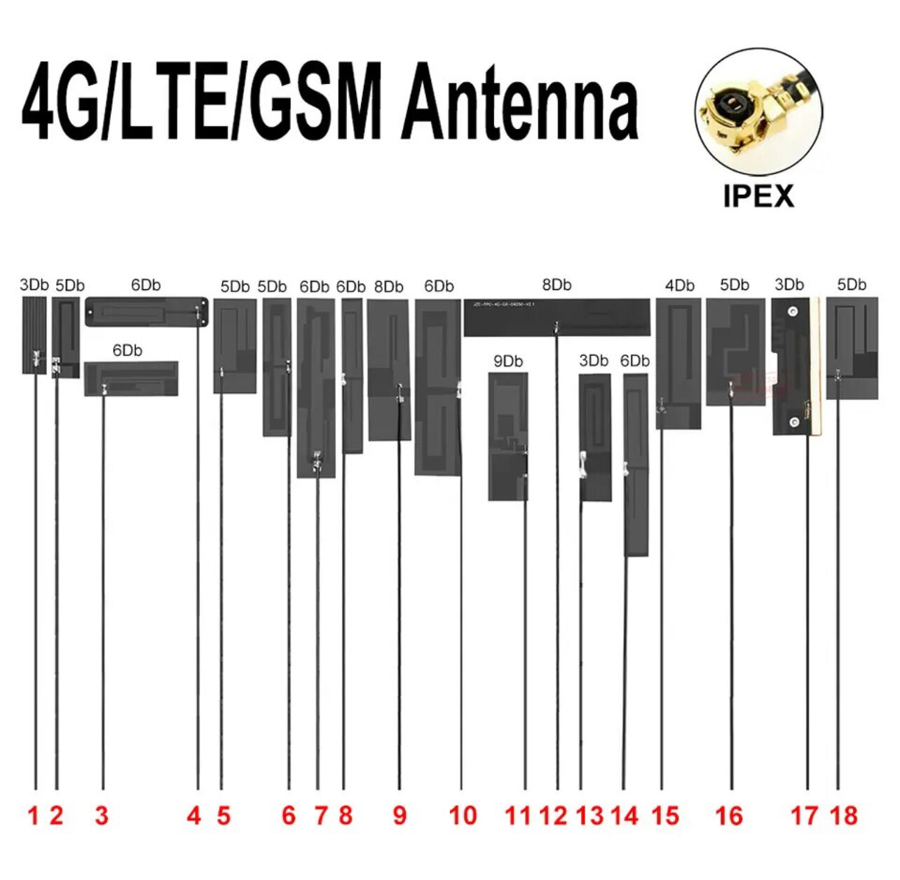

Next Step replace LTE antenna with this one
Just found this amazing item on AliExpress. Check it out! 3,33€ 20% Off | 2Pcs LTE 4G 3G GSM 2G NB-IOT Antenna IPEX UFL IPX FPC Build-in Omni Antenna High Gain For EC25 EP06 SIM7600 MC7455 ME909S-120
https://a.aliexpress.com/_EI1nfF3
also Nr. 14
