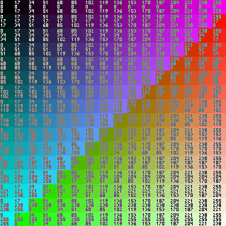

I wrote a little code to test colors.
And usually for random colors I do RGB(RND*255,RND*255,RND*255)
