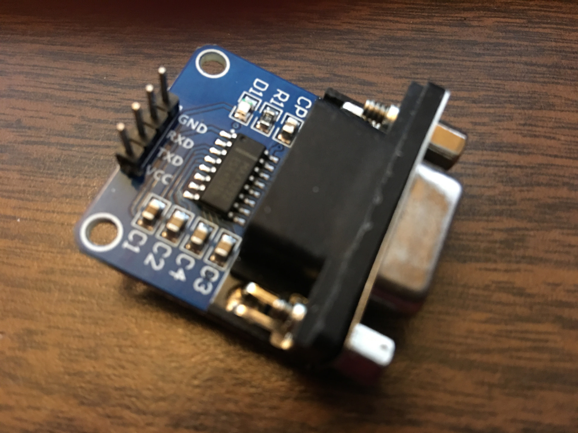

I have a standard RS-232 port using a cheap TTL to RS-232 converter (see below) The USB port can’t be used to connect to a real RS-232 device, only a PC, tablet or smartphone via their USB port.
Thanks Tom, my stuff with real RS232 ports is not a problem. I have one piece of gear that only has a USB port, no rs232. That’s the one I need to send text strings to. In Python on a PC I use the VISA libraries to do that.
