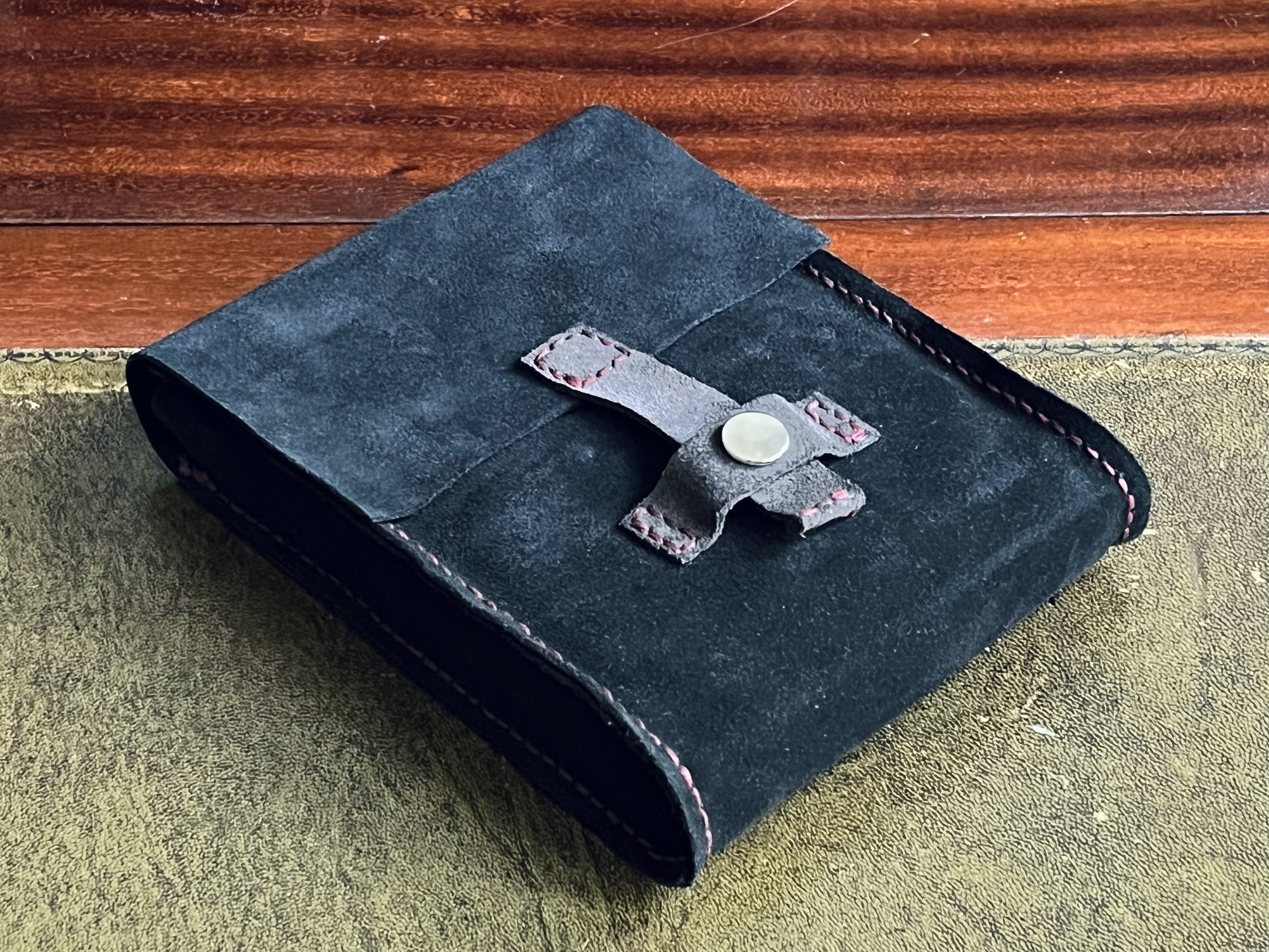

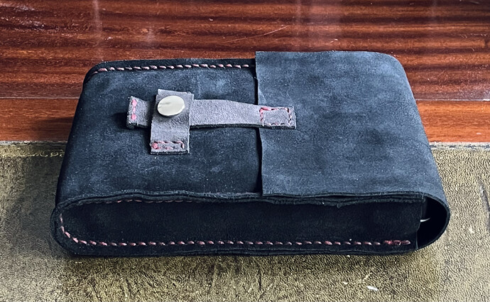

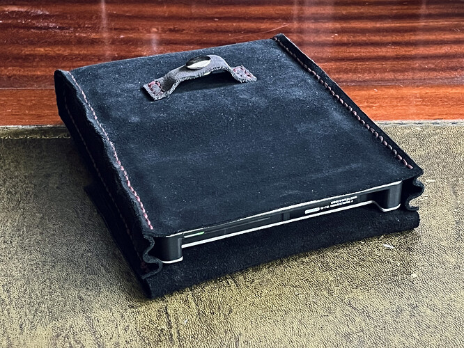

Custom leather pouch for my uConsole
I made a leather pouch for my uConsole since I carry it around a lot at university in a larger bag with all sorts of things so it needs some protection. It’s made from suede leather so it’s relatively soft. The latch closes with a snap button.
It’s all made entirely by hand. Took about 3-4h total.

wait, you sewed the case completly by hand? the stiches look absolutely perfect, so i assumed you used a sewing machine. this is absolutely impressive.
yup, all by hand, from cutting to stitching to fitting the button :slight_smile:

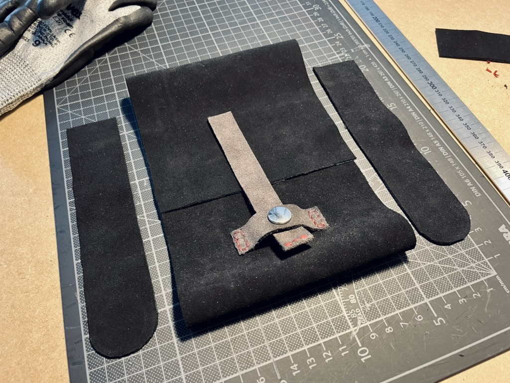

I would like to sew one, too. Is there any way to get the sewing pattern for this pouch :heart_eyes:
I don’t have a pattern since I just measured things by eye with the device itself as a reference. Here are photos of the individual parts though if that helps:
I’m not sure if you mean regular sewing though, because that won’t work with leather. Most normal sewing machines aren’t strong enough for that either. You’ll need to pre-punch the holes for the stitches in order to get a needle through along with the waxed thread that you need.
Unless you already know how to stitch leather, then ignore what I said and go ahead :slight_smile:
Perfect! I have sewn leather slippers (Pantoffel) for my kids a few years ago with my sewing machine, broke a few needles in the process though. Maybe it depends on the thickness of the leather?
Thanks for sharing nontheless!
You can try and use saddle-maker’s needles if they fit your machine I guess. But they are less sharp (since they assume pre-punched holes) but also more robust. But I don’t think the waxed thread would work well in a sewing machine.

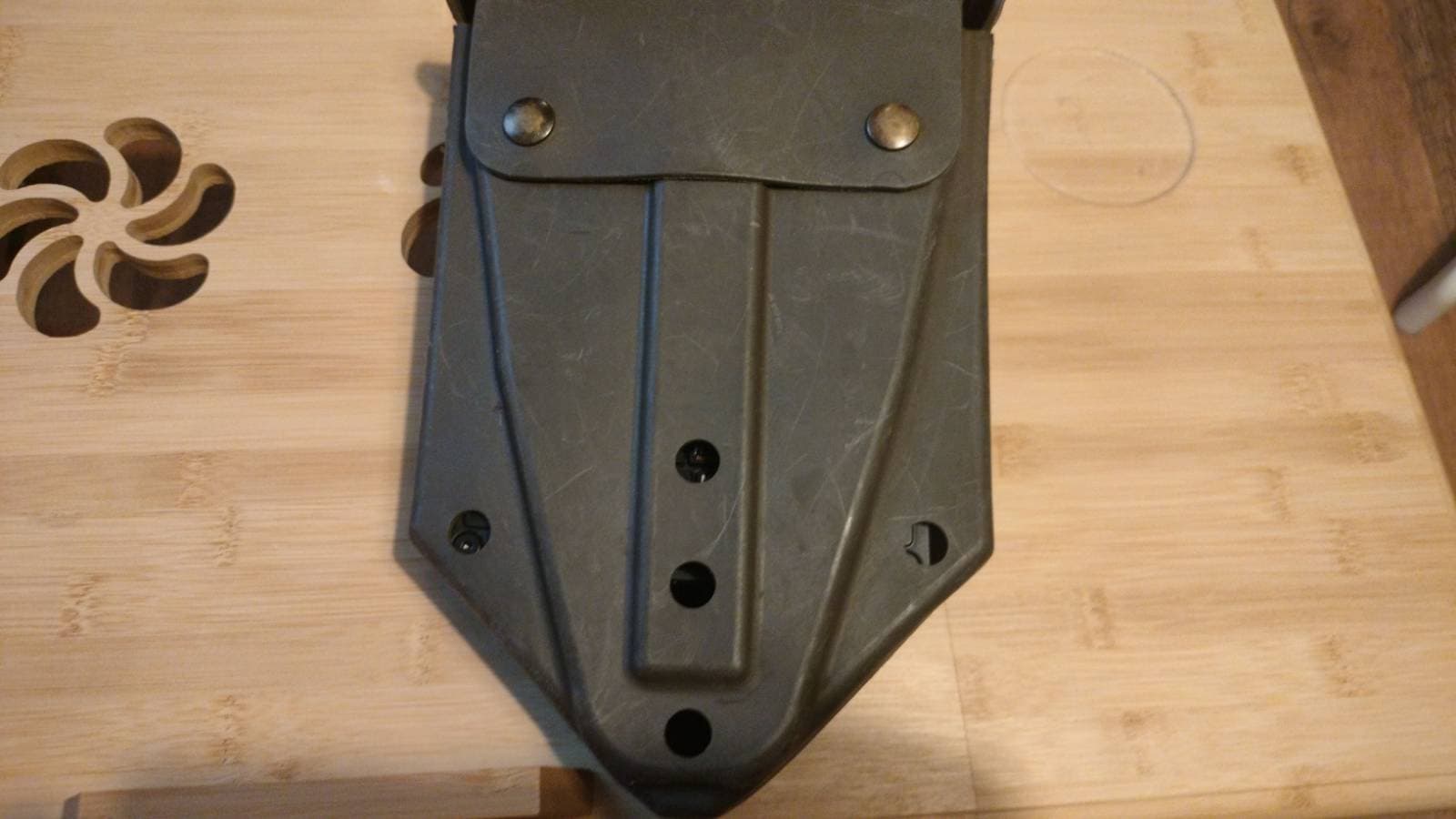

I asked my friend to make that!
Not that creative - Amazon Thigh Bag, Larswon Leg Pouch Bag Thigh Pack Bag Tactical Waist Bag Motorcycle Bag Waterproof Black
