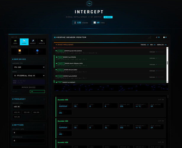

Installed Intercept app from GitHub - smittix/intercept it provides an easy to use front end for POCSAG and FLEX decoding, 433mhz sensor decoding, ADS-B, SAT tracking, WIFI and BT Scanning in a combined web app. If you want to install this I recommend using install option 3 on a virtual environment as it’s the easiest way to get it up and running, Make sure to install the dependencies prior to installation to insure that it works properly. So far it’s working great for me on Rex’s Ubuntu image just need to set up for auto execution on startup. @Rex this could be a good addition to the HG-AIO package.

I’ve been enjoying playing with Intercept mostly. It’s really nice to have all the SDR services bundled into one dashboard. The biggest challenge for me has honestly been the uconsoles screen and the way the Intercept UI responds to changes in zoom. When I have it zoomed out enough for a clean layout it can be hard to read all the information. Has anyone found a good way to balance layout and text size?
I just hit the ip address from my laptop. :rofl:
