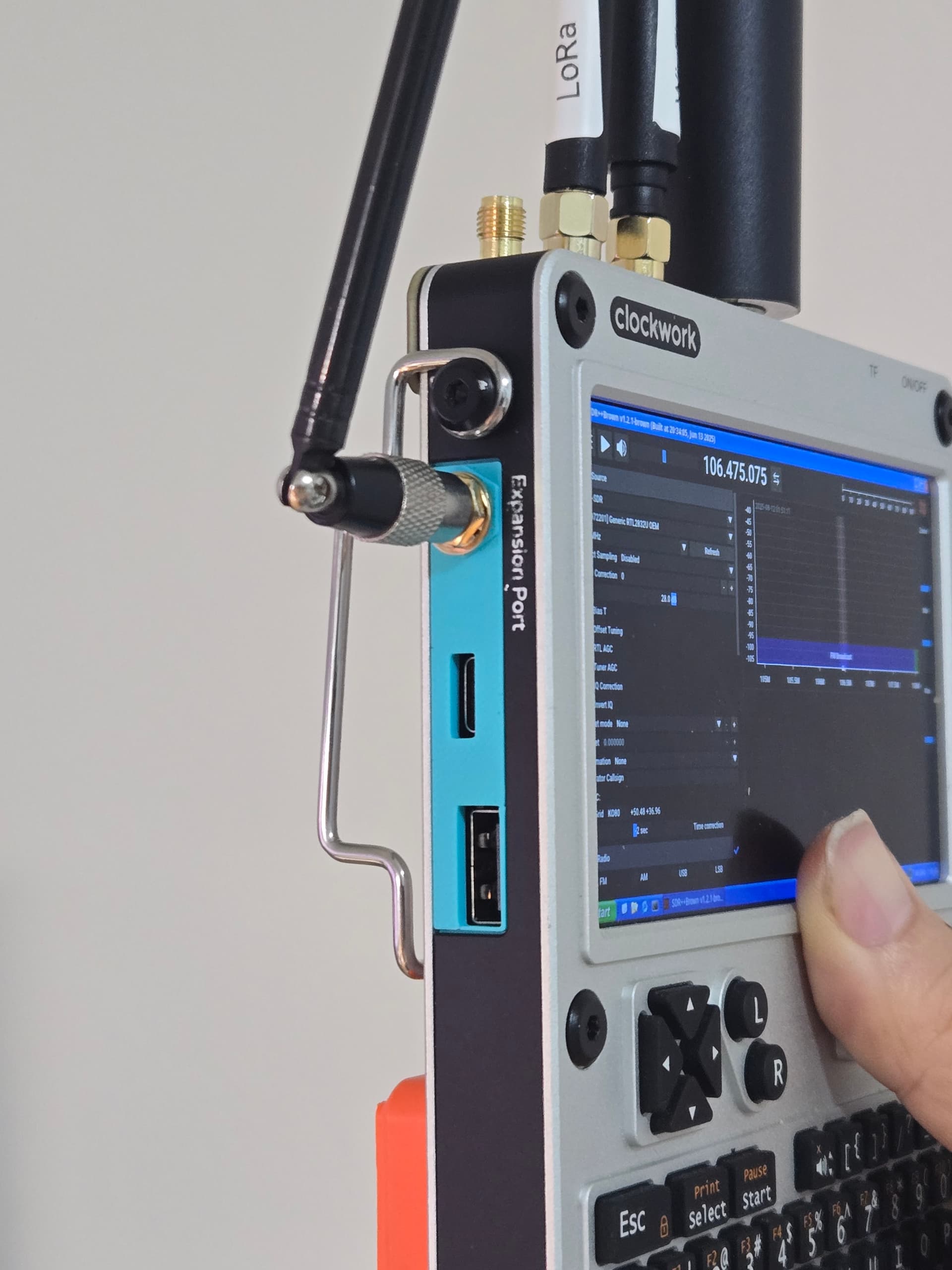

So if you got the AIO board you probably have already found the stock side panel a pain to deal with. Now if you have a 3D printer you can print this improved side panel, which helps a lot by:
  1. Fixing the SMA port a lot better, the stock plate would strip due to being too soft and thin, this one though printed with PLA, it’s much thicker and sturdier.
  2. Fixing the SMA port with some angle selection, so that the stock SDR antenna can fit better on the side panel.
I was planning to upload to makerworld for farming boosts, but they won’t let me because I’m using the latest beta version of Bambu Studio, and it’s a beta so it’s not supported. Anyway I would upload it to my gdrive, as a gratitude to all the folks helped each other here (especially @Rex), and you can download it from here:

Do one with a little space for the rpi-camera ribbon cable to fit through. :smiley:
I don’t have the camera and ribbon cable.. :frowning:
We just need a very thin slot against one edge near the usb-c tbh. Could use a nail file and take of like 1mm and be reyt.
