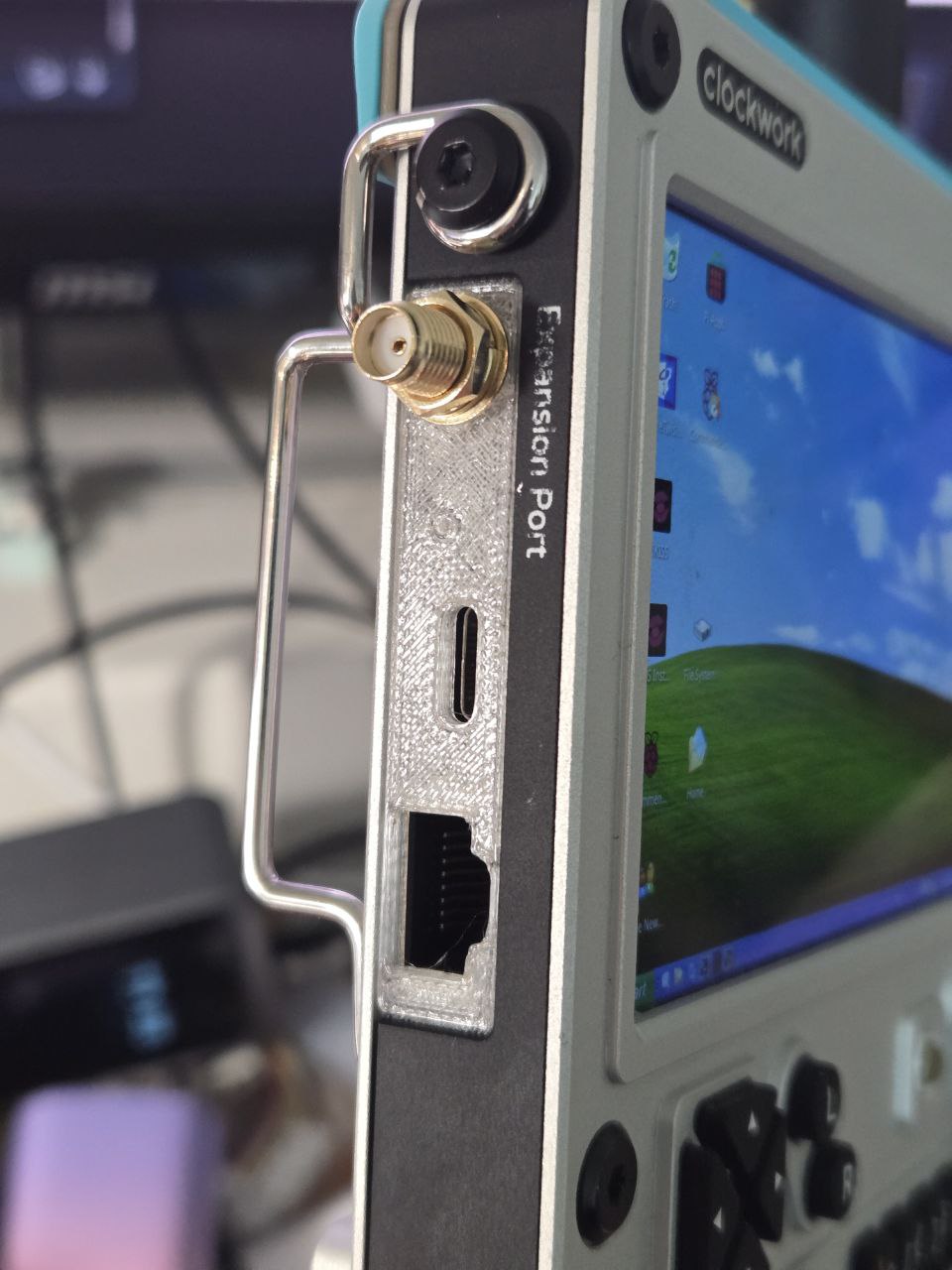

Hacker Gadget AIO v2 Improved Side Panel
Improvement: Improved the fixing of SMA port, now it would not strip the panel easily anymore.
Printing: watch out for the ethernet port. The walls generated there is a bit weak but I managed to install it without breaking it. Be careful when you’re removing it from the build plate.
Mine was printed in transluscent PETG. This allows you to see the ethernet signal lights and also the SDR signal lights.
Hi do you have one for the aio F1 the older one
What is the small hole beside the USB-C port for?
seeing the bias T LED
If you’re not printing in transparent materials this can help you to see the leds inside…
