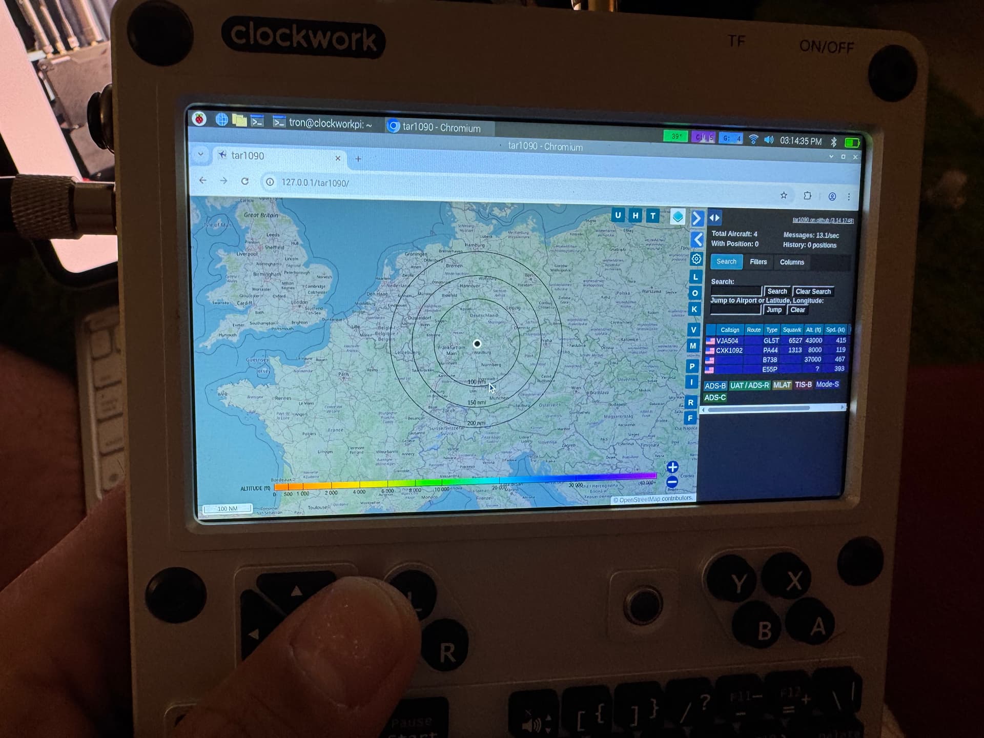

Tar1090 seems to launch for me and appears to be receiving transmissions from planes but the map has me set in Germany (I’m in Chicago) and doesn’t plot any of the planes locations. Any ideas? PyGPS works just fine.
does it plot them if you move the map to chicago?
No, it doesn’t show anything if I move the map over to where I am. Do I need to move the rings around where it thinks I am?
no it just hasn’t received any position reports yet, the rings and default map position are just a visual guide and have nothing to do with the reception and decoding
