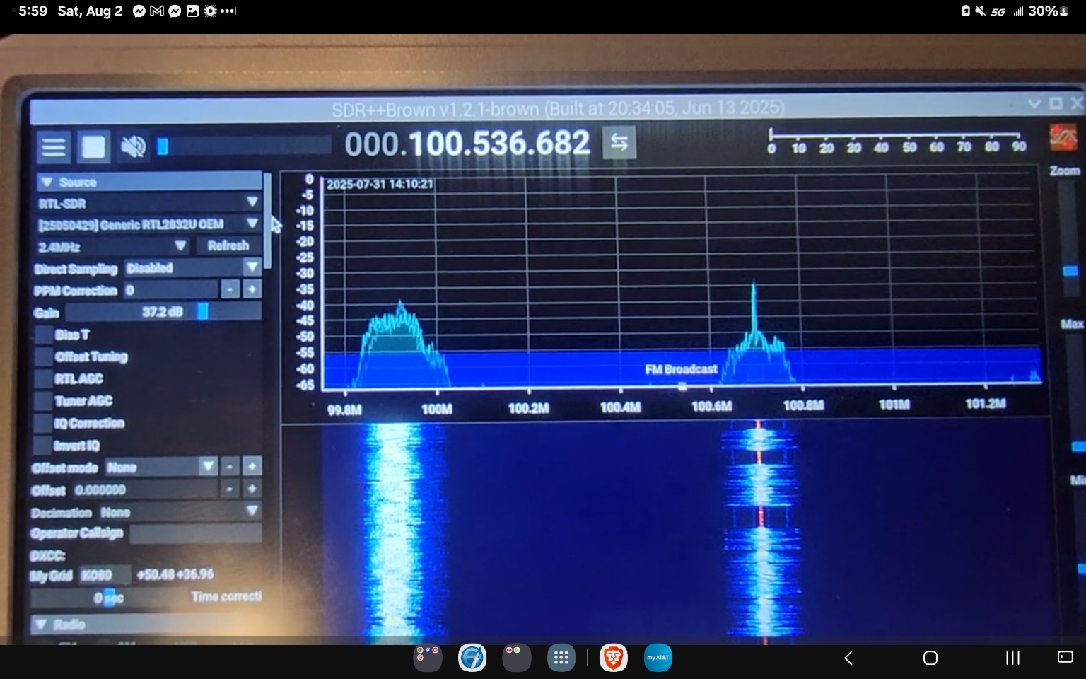

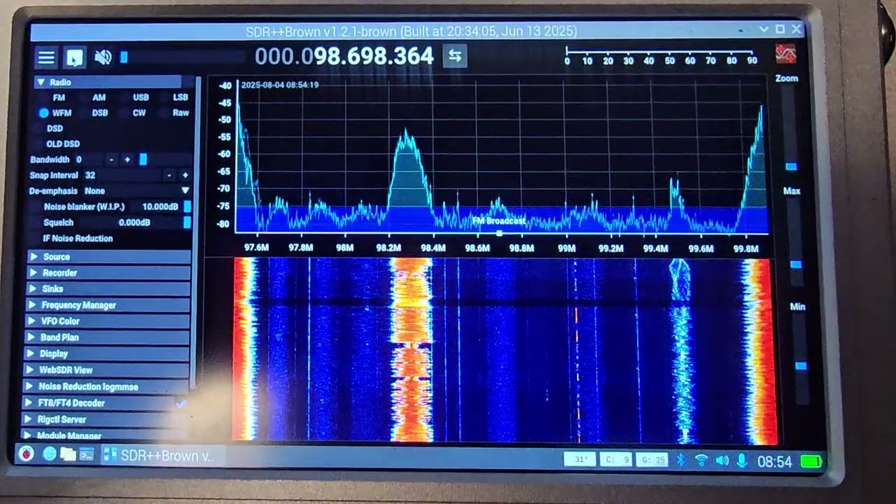

Thanks for a great build, I received my uConsole in June and my AIO board shortly after. I upgraded to an RPI CM5 16gb/64gb EMMC and installed the Bookworm image. The only application that I have not been able to get working Has been SDR++ Brown. The app launches and when I press the Play/Stop button I see RF activity but the volume control button is greyed out and the volume slider is unavailable. Sound works fine in all other applications. Also in the FFT window there is no VFO Line at selected frequency. I am unable to change The modulation type in the Radio Module. The WFM is selected and not others can be checked. Squelch cannot be checked.

I get video unavailable from the YouTube link. Can you post a screenshot?
see that checkbox next to radio? turn that on, it will turn on the radio sink which turns the received signal into audio
Thank you, My Old Eyes thought that was space at the end of the volume range. WOW.
This is great, Everything is working now.

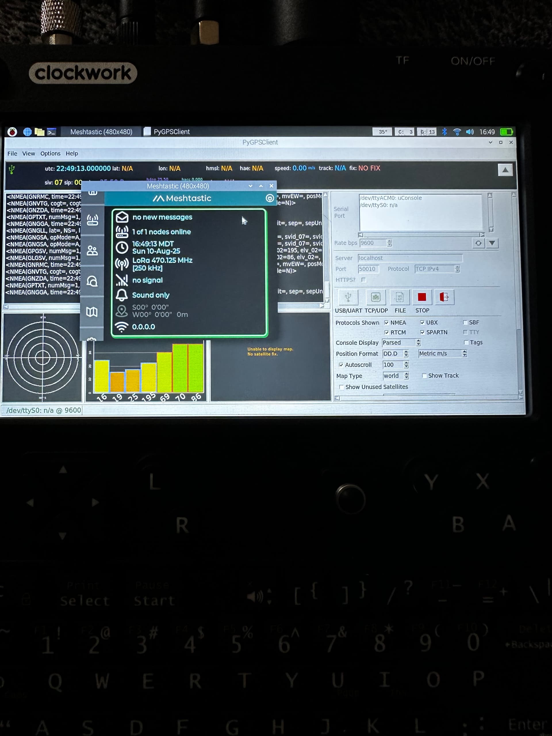

Trying to decide if I have bad hardware here. My GPS data stream appears to be corrupt, and the LoRa can’t find nodes anymore. RTL-SDR is the only thing that works on this board. Should I seek a replacement, or is this a software issue?
Output from /dev/ttyS0 at 9600 baud:
Thinks I’d do, check for any damage on the board, make sure it and the antennas are seated correctly. Try a fresh image on a second SD and install this package again and test.
Looks like it’s related to a gpsd socket. If I start the gpsd service (then stop it), the feed goes corrupt. Has anyone successfully configured GPSD against this device yet? (FWIW, I’m about to deep dive through the forum to find out…)

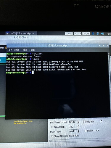

Is Lora and GPS working? Post the output from lsusb
LoRa & GPS are not working , it indicates LoRa in meshtastic but does not have signal
Rtl_test
lsusb
You will only get a signal when your device makes contact with another node. Meshtastic is working and you GPS is working. The SDR is not showing up in the USB devices though.
I’d take the expansion card out check for any damage and reseat the card and test again. If the SDR still doesn’t show up under lsusb you might need to contact @vileer for support.
