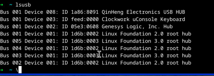

@vileer Hi Vileer my RTL-SDR started to disappear from the lsusb results.
Do I need to replace the board?

I did, got a new board, put it in and it all worked. Never found out what was wrong with the other one. All the solder joints and parts looked fine.

Thanks, guess I’ll try to get my replacement then.
