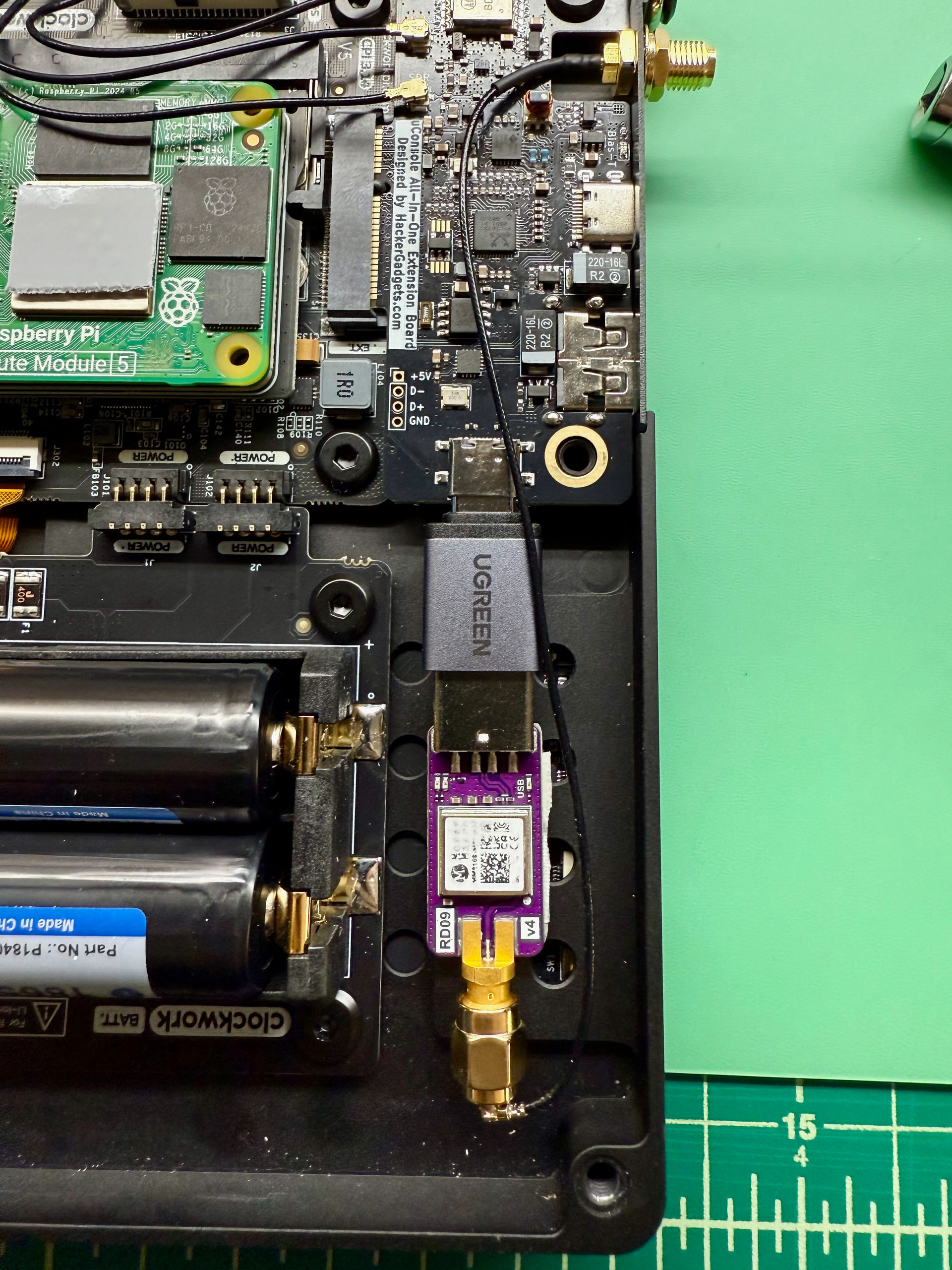

has anyone put a halow(802.11ah) module in their uconsole?
someone did a second wifi: uConsole Mod Megathread - #76 by null
so you just need to get an expansion with internal usb / solder to free usb on your expansion card (not sure if 4g module has free usb to solder to)
[Full Disclosure: I work for Morse Micro.]
Yes, I have, attached to the internal USB-C on a Hacker Gadgets board. It’s a bit ugly, as the USB reference designs we made were the wrong mix of connectors. Our partners will have a USB-C dongle with SMA available soon (I was showing two of them at CES), but I don’t have details yet. That will make enough room to get rid of both adapters and just use a M-F SMA cable.
The hard part is getting those usbs without the added router.
Our partners will be shipping without the router. What you’re seeing on Mouser now is an eval kit which includes a “known good” platform with pre-loaded drivers.
Nice ! I plan on doing the same thing. Do you know when the partners will be selling just the dongle ?
