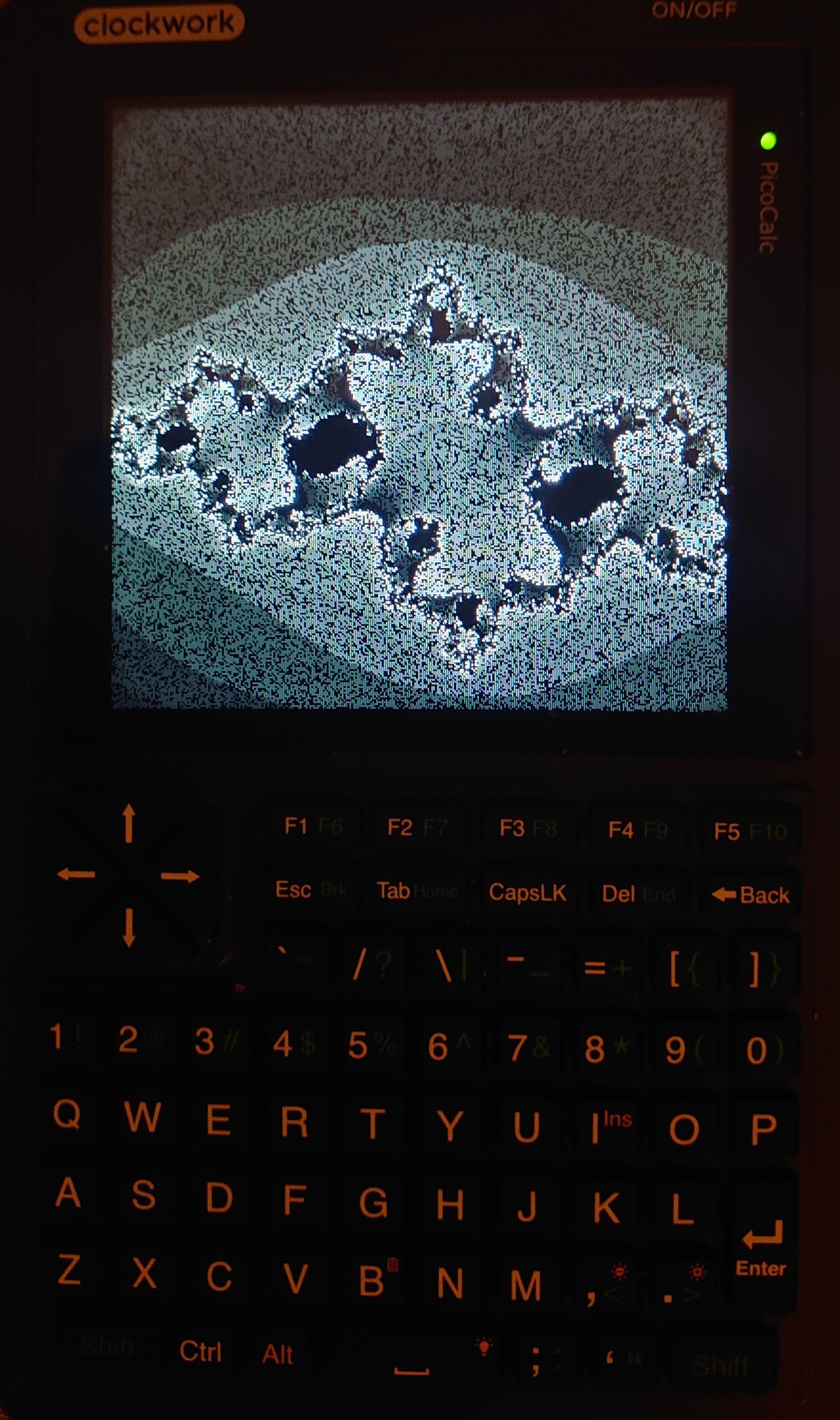

I was playing around with the Julia set program from over in the Shed and
it occured to me that FOR loops plotting sequentially is painfully slow to watch; mand.bas
even assumes you want to save a bitmap at the end of the ordeal.
So I replaced them with a never ending DO loop and that just picks random points. (ie:
FOR X=0 to 319 becomes X=319*RND) The picocalc is fast enough that the image is recognizable in about 30 secs and somewhat entertaining to watch as the calculation/plotting drags on.
Of course, there’s nothing to stop it from hitting the same points over and over unless I keep track of what has been already plotted. (A 320x320 array is too big.) So can I PEEK into screen memory somehow and get what value is stored at the address corresponding to pixel X,Y?
