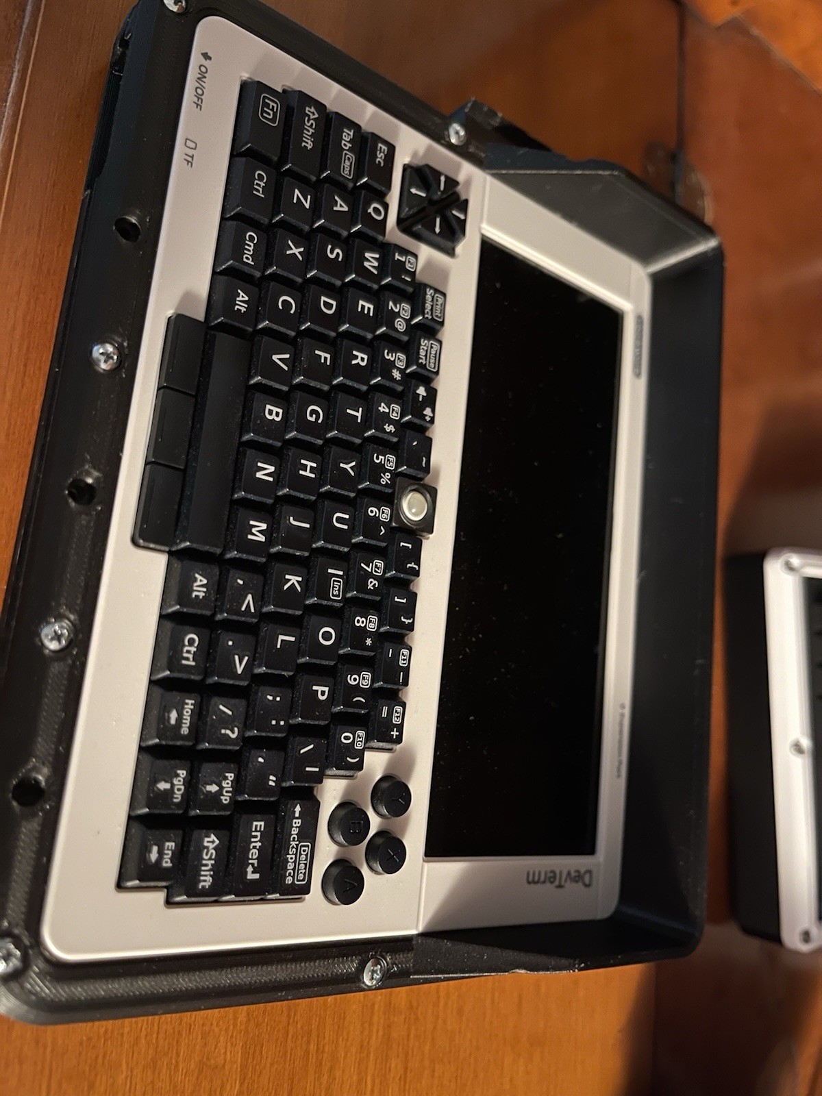

It also came with this weird 3d-printed frame around it. What is this thing? It just seems to add more weight to an already big device and doesn’t provide much protection….

Interesting, that surround frame looks like it was intended for wall-mounting or such (thus the hood to block glare from above). Is there anything on the back of it to suggest it’s a mounting bracket? Can you upload a picture of the back of it?
If it covers the back, be aware that might potentially cause a thermal issue with the CM4, depending on a) whether it has the graphite heat sink installed, and b) how it was installed.

As for the wierd frame, I finally took it off again as it kept catching on things when you insert/remove the devterm from a backpack. The back of it is open so there is no danger of overheating.
