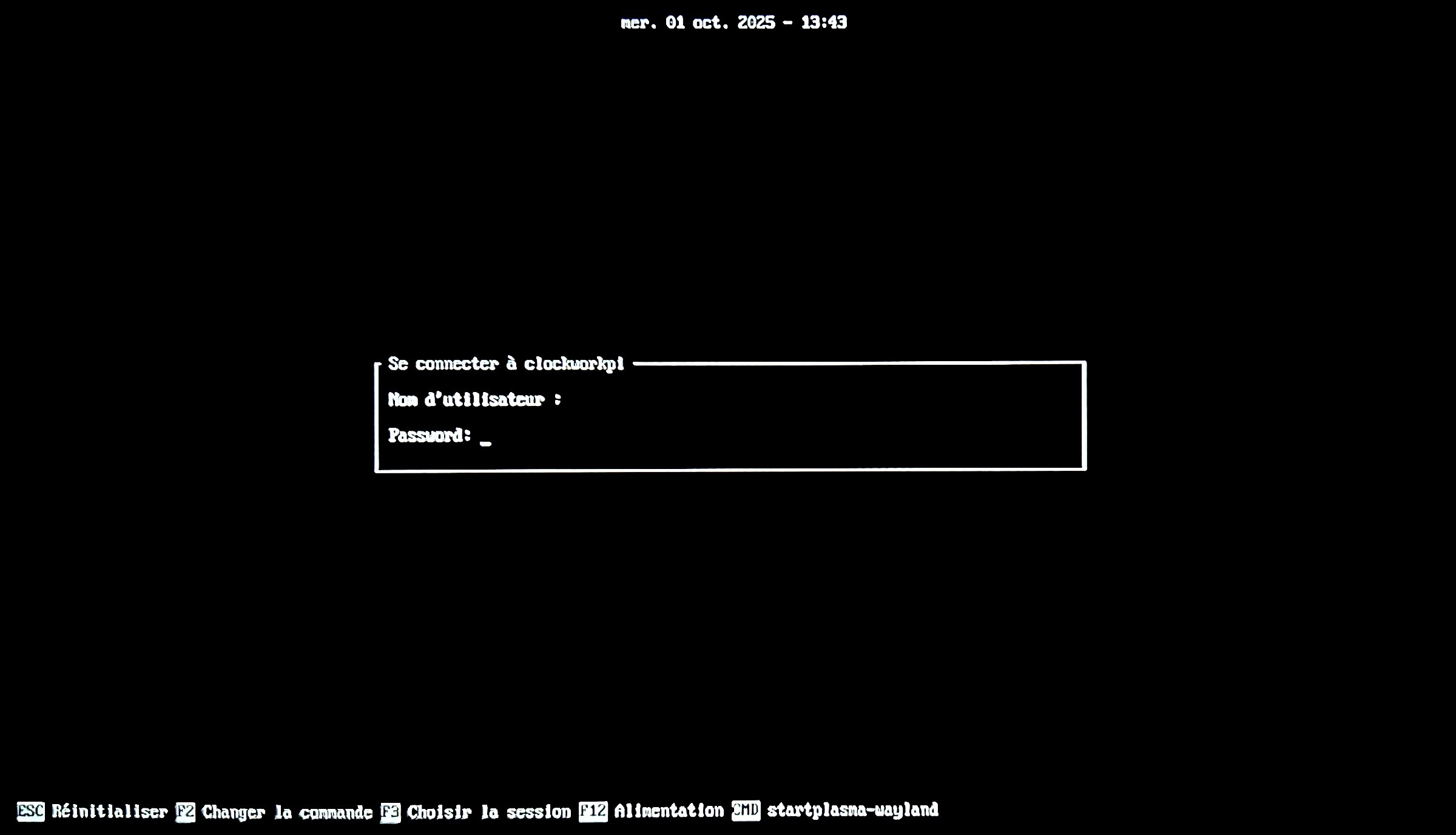

3- Configure Greetd (the Desktop Manager to login) :
sudo nano /etc/greetd/config.toml
(“nano” is a very useful command line text editor)
[terminal]
# select the tty to use :
vt = 2
[default_session]
command = "tuigreet --time --remember --cmd startplasma-wayland"
user = "_greetd"
# Autologin at boot
#[initial_session]
#command = "startplasma-wayland"
#replace user_name to your login
#user = "user_name"
then, Ctrl+X and “y” for yes.
4- Auto-launch greetd at start :
sudo systemctl enable greetd.service
sudo systemctl set-default graphical.target
(Boot in graphical mode by default to avoid conflicts. It’s recommended)
5- Hide tty2 to prevent it from reactivating during an update*:sweat_smile: :
*Yes, it happened to me…
sudo systemctl mask getty@tty2.service
6- Reboot !
After rebooting, greetd should appear directly on tty2 and the login appears.

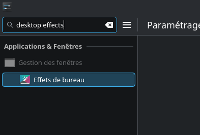

7- Bonus, lighten KDE, add Flatpak repo :
go to Settings Settingsand type “desktop effect” in the shearch :
Uncheck all as you want ! Each of these effects uses precious CPU cycles.
