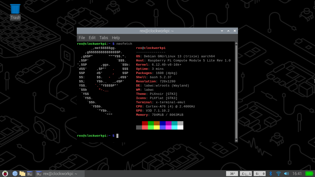

Features: ClockworkPi-Trixie-6.12.y
  • Desktop and Lite images available.
  • Image built using Pi-Gen.
  • Dark mode for all screens (first boot, login, desktop)
  • Sane charging defaults applied.
  • Kernel updates though my APT repo.
  • External WiFi antenna already set in config.txt.
  • A few clockworkpi images for wallpapers.
  • Activate 4g card by uconsole-4g enable and uconsole-4g disable
  • linux-headers included with kernel
  • Works with both DevTerm CM4/5 and uConsole CM3+/4/4S/5.
  • Auto-expanding file system
    • On first boot system will boot expand FS then reboot.
  • Updated driver overlays - easier config.txt management.
    • Just follow the instructions at the bottom of the config.txt
