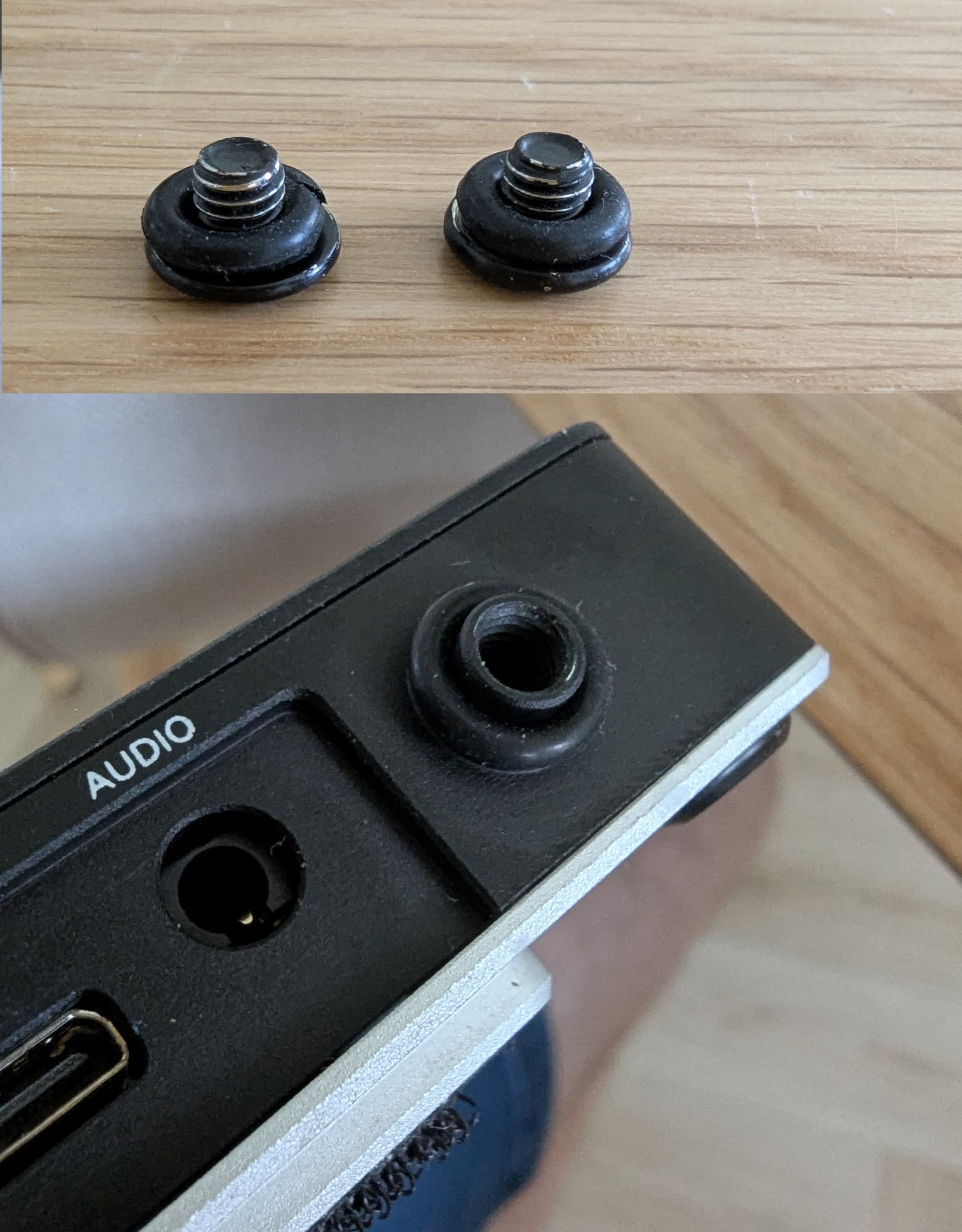

Kickstand rattle
If there is anyone else, annoyed by the rattle the kickstand makes, when in the closed position, read on.
I wanted a quick and easy fix for this.
Solution - o-rings (5 in total).
The first one, goes under the screw, that locks the kickstand while closed.
And the next 4 - 2 on each side, one on the bolt, and one between the wire stand and the body of the uConsole. This way, when you tighten it up, the stand is pressed by the two o-rings.
Fast, cheap and easy.
Thanks for the tip! I don’t have mine yet but will be trying this as soon as I get it.
I bent mine so it held the screw on the back tighter, so far that has worked for me.
