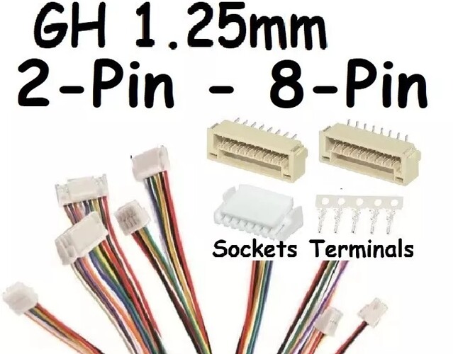

Does anyone know what size the JST connector needs to be for the USB header on top of the board? Thanks!
4-Pin
Is this what you are looking for?
Exactly! Yes. Thank you.
