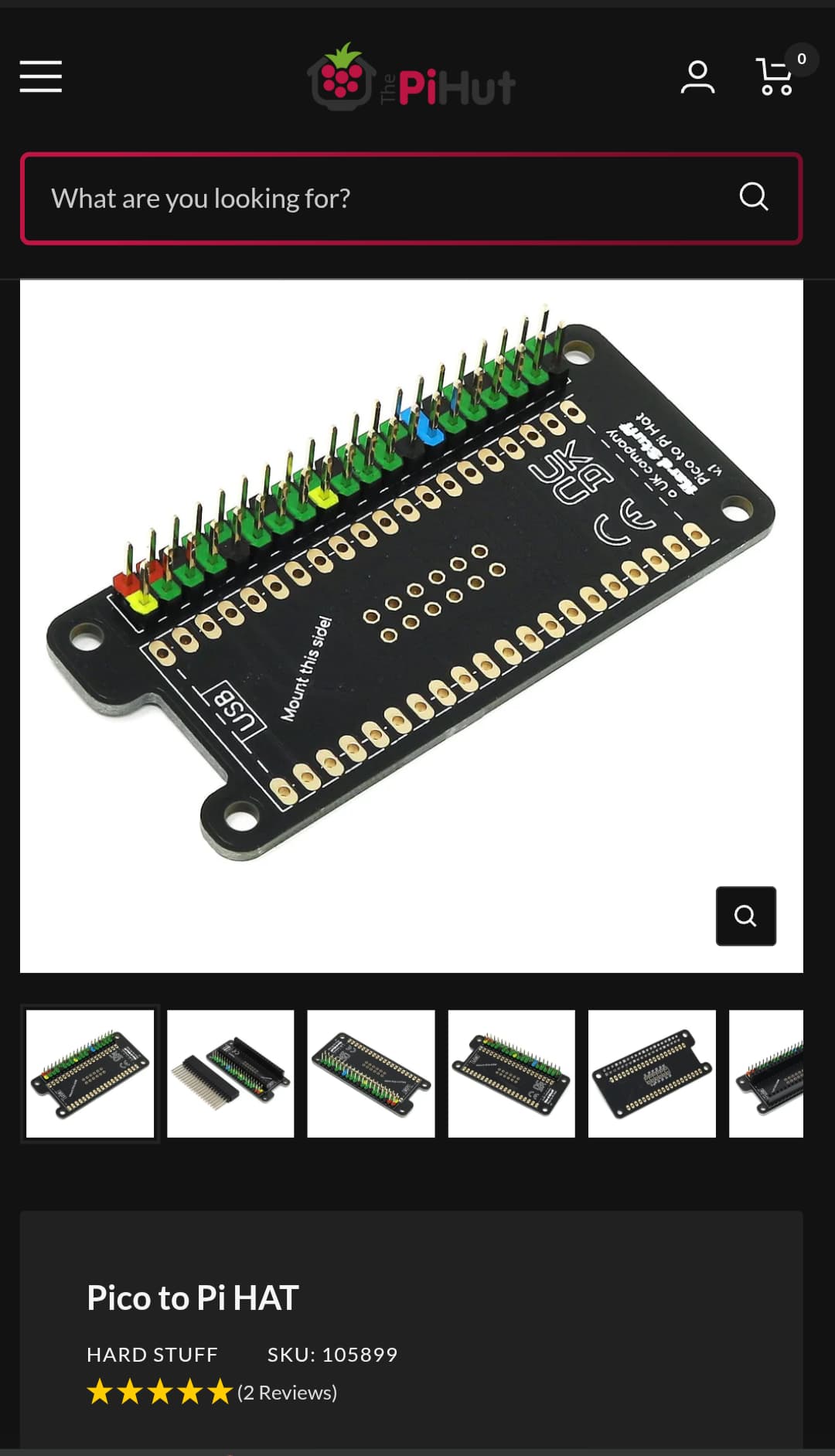

I saw this link in another thread for a Pico-to-Pi 0 adapter board, I wonder if this would work?
Pico To Pi 0 adapter board

Someone tried - and succeeded: https://www.youtube.com/watch?v=wgE0R1M0_ZE
Here is the thread:
https://forum.clockworkpi.com/t/raspberry-pi-zero-2-on-picocalc
