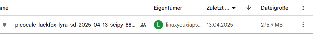

I wonder if I missed some.
I can’t find that in the googler drive? Also not a newer raw-sd that this:
Cheers,
Carsten
From what I can see in the source, it seems like the devicetree is missing the external sd card support. it’s there in the image, though…
