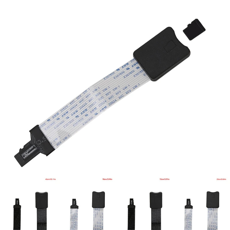

Luckfox Lyra on PicoCalc
Found this on AliExpress, seems almost purpose built for this application on the luckfox Lyra pico and pro
https://a.aliexpress.com/_mN4189d
Thought’s…
Seems to me that if this works it would mitigate the voltage issues of trying some of these bogged in solutions, altho I don’t know if the Lyra images that have been produced so far make use of the full size sd cards slot on the picocalc or if there trying to use the Lyra SD card slot so that might be an issue…
I thought I would just point this out and get a second opinion or 2, I’m probably going to pull the trigger on a couple of these and a couple Lyra picos with different flash configs to tinker with because ultimately I really want a handheld low resource wifi enabled ssh client lol, this might be what makes that finally possible, Im still holding out hope for at least a monochrome ssh client for the pico2w but it seems to me that resources are to limited there and a lot of folks are bifurcating there attention to more powerful alternatives for there aspiring application on this well designed picocalc(yes I’m a bit salty at the thrown together and basically abandoned nature of the uconsole, seriously at this price?)

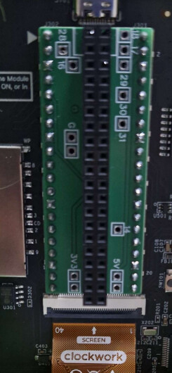

It does not fit with the mipi dsi connector. On my board I removed it. But the wifi is working fine and it fits into the picocalc case.
Yes, the mipi connector is in the way of using also a tf card extension. It would have helped if the tf card was rotated 90 degrees
At least i can use this with the Luckfox Lyra Zero W running on my PicoCalc via my adapter
Where can I find this adapter?
not on sale made myself

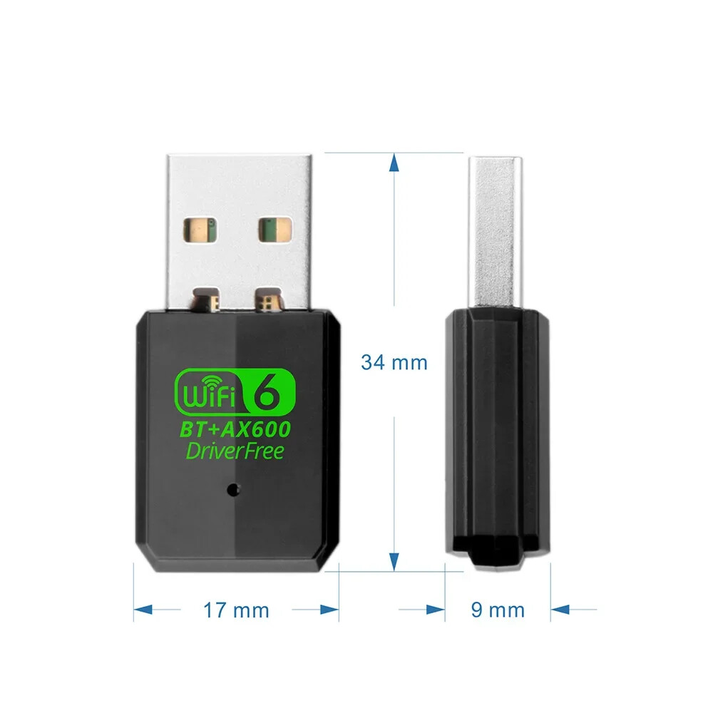

I have received that similar wifi dongle
Driver free for Windows only (driver on the dongle itself)
Bus 001 Device 003: ID 368b:8d81 AICSemi AIC 8800D80
600M and BT5.4
https://www.aliexpress.com/item/1005009015074856.html
working with this driver
