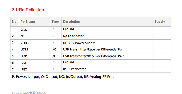

How are the pins/wires connected to the Lyra and the BL-M8188FU3? A diagram or list of the connections would be great. I’m sure some of us would like to use this, but we’re all not as hardware savvy and I wouldn’t know how to connect it up. Thanks!
Edit:
Actually, it looks like the picture is fine. I didn’t realize it was so high resolution and after zooming in, I could see where the pins go on the BL-M8188FU3. Still, a pin diagram might be helpful, but the picture is probably good enough. :slight_smile:
Hi,
It is straight forward:
On the Lyra Port you have the Pins are described as V,D-,D+,G.

Is there a reason you did not take the red wire also from the connector? Is it maybe because usb is 5v and the wifi module needs 3.3?

I wonder if there is some way to use the wire from the connector (presumably 5v) and safely reduce it down to 3.3v by putting something between it and the wifi moduile? Seems like it might be cleaner than soldering to the Lyra itself if the wifi module wasn’t needed later.
(Genuine question. I’m not a hardware guy, so I’m not sure if such a thing exists.)
google “5V to 3.3V Voltage Regulators & Voltage Controllers
there are plenty of options
Thanks! I figured such a thing (or many things!) would exist.
