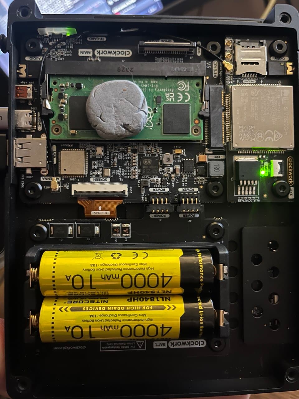

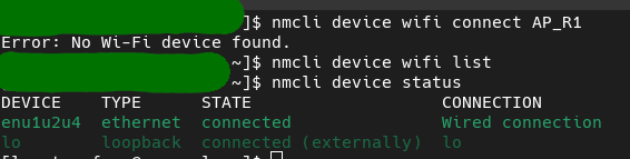

Hello I tried this image with cm4s, it seems good but no wifi / bluetooth.
Thanks for the work
Is your WiFi antenna plugged into the CM4 or the main board?
It needs to be plugged into the CM4.
Ohh yes sorry.

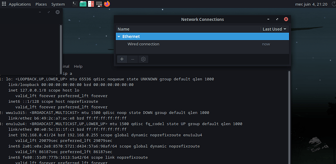

I can see the 4G module not loading in dmesg
There was no wifi interface before (wwu1u3i5) I think I messed up with some virtual config or something.
But yeah it’s well connected in ant1, I even tried in config.txt different stuff but not working either.
I will try without the 4G module first.
