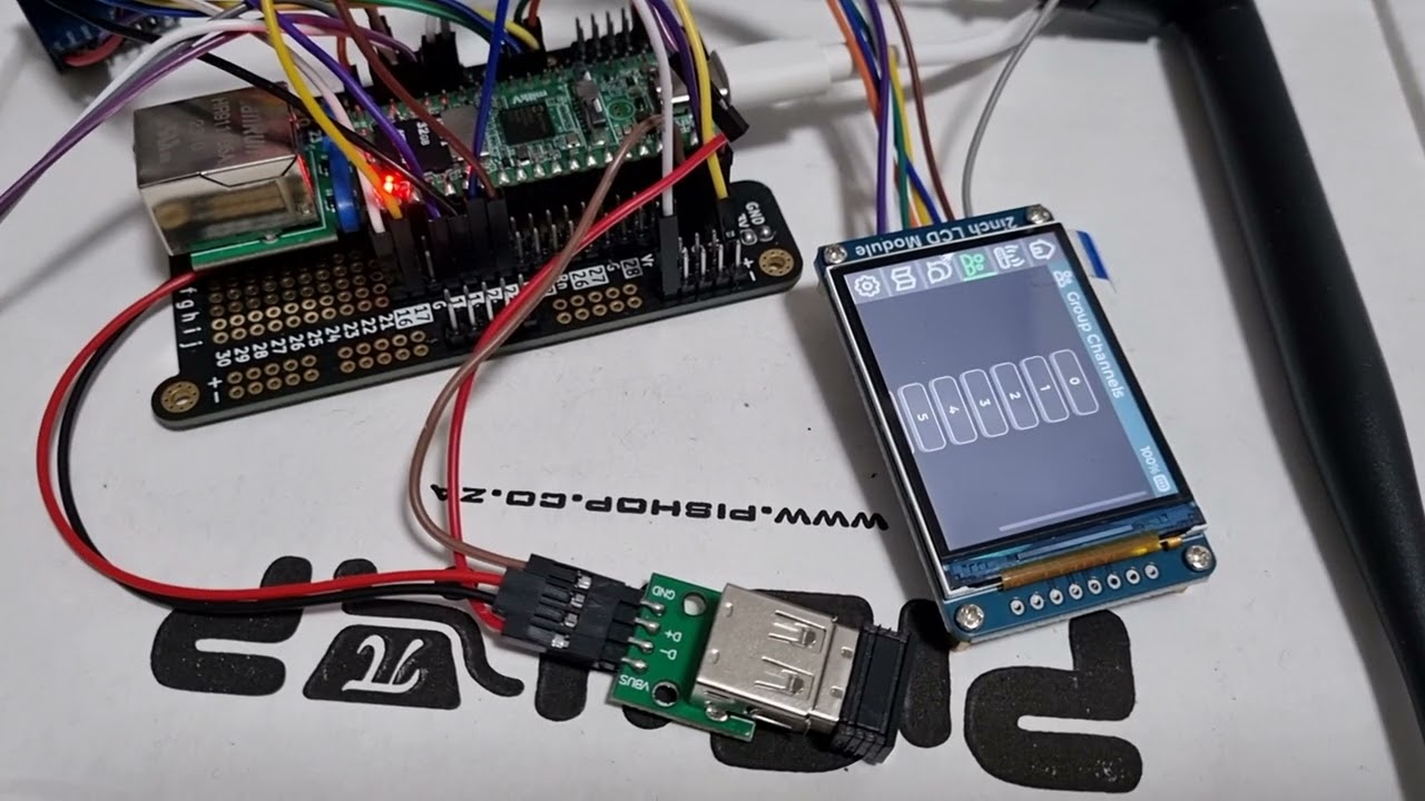

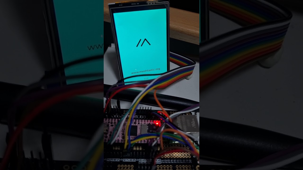

Nice! Yes, I seen your video, some days ago. Is it running over Linux image? or is Meshtastic running like a standalone app? Can you share the code? thanks!
Yes, modified Ubuntu image. Running native-linuux meshtaticd part of - GitHub - meshtastic/firmware: The official firmware for Meshtastic, an open-source, off-grid mesh communication system.
you should join the discord server for meshtastic
the process is bit involved that why instead above i ran the milk-v duo-256 in ARM64 mode to simply the install on meshtasticd
I knew the Meshtastic Project, I have a T-Deck and other LoRA devices, but I never tested the native-tft env from PlatformIO. I didn’t know that it deploy a Linux image with its Meshtastic app.
Yes, so the specific linux board os part is still somewhat separate.

here for example is the duo-256 arm64 sdk changes i made to get the board kernel configure for spi etc
then i mix in the armbian rootfs instead of buildroot
and compiled on the device above, but there is now already arm64 meshtastic ready build packages available here -
and also i have my own usb meshstick dongle

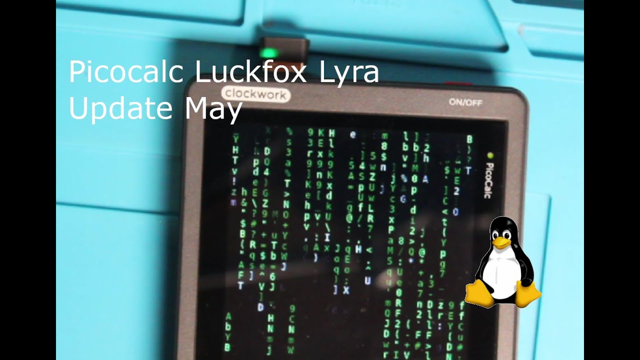

Thanks to share this info! The question now, is it possible to add the Picocalc screen and keyboard driver like a simple PlatformIO project? I mean, like a standalone application with a simple TFT library for instance? or we would need put the drivers of Picocalc like a buildroot package? or like a overlay driver? I ask that because you have a different TFT display.
For Ubuntu on Picocalc with Luckfox Lyra core ,I took the approach of adding
the drivers to the kernel in the sdk.
The MilkV is not pinout compatible so that will be your next issue.
