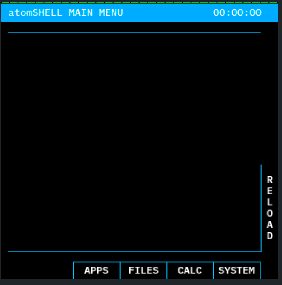

Also I am writing the UI shell for NuttX(LVGL), where you can run normal apps and WASM apps.
Source also will be available as custom app for NuttX and will be used as init/startup app in picocalc-nx board.
