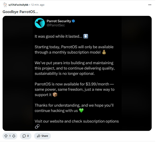

Did you guys see this ?
1st april?
oh ffs :smiley: i walked right into it, didn’t I ?
no worries mate!
now please transfer me $3.99 for the help.
Give me few days to secure a bank loan. I’ll get back to you :smiley:
I hear @white-round-square takes Afterpay! Pay in 4 interest-free installments!
Apply Here!
