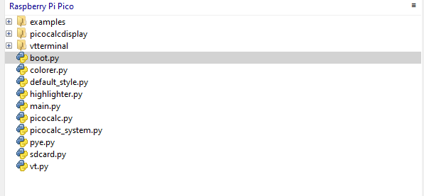

I have, I can use Thonny to look at and interact with the microcontroller. If I disconnect micro-usb and give power to my picocalc, nothing happens, just an orange charge light.
This is what I’ve managed to suss out that should allow it to boot.
what firmware are you talking about ?
Micropython ? PiocMite???
